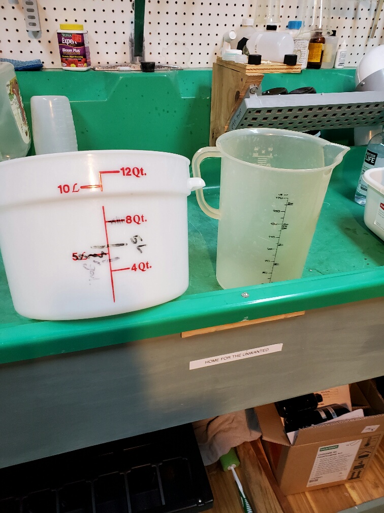

Here's what I started with, note the markings are totally wrong. I calibrated it with 1000 mL graduated cylinder. On the right is my precious German beaker calibrated in dopey American ounces and metric. And my bottles for storing solutions. Soda bottles work great for XTOL, PET, just fill and squeeze out the air. If I can't fill a bottle I throw it out.
I've used 2 year old XTOL, no troubles. But oxygen is vicious on developers. Watch the tv and see the forest fires. No air in bottles!
