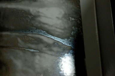

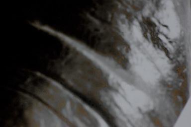

Hey all,
I have a couple of prints on my wall that have started to degrade, I only noticed it when looking closely (cleaning the frames). They've started getting a reflective (the metamerism is what I noticed first) bronze appearance in the shadows/lower-midtones. It's uniform across the print (not just the edges) but definitely correlates with the denser parts. A couple of Zone-III regions have it speckled across them, and it forms dense lines of reflectivity where light & dark parts of the print meet. The darkest regions don't seem to have it and the higher zones are clear. It has a bronze appearance in diffuse light and a silvery appearance from straight-on - see attached.
The paper is Arista.EDU RC VC gloss, aka Foma Variant, developed in Ilford Multigrade 1+7, fixed for 1:00 in Hypam 1+4, washed for 4:00 (continuous agitation) with 6 changes of water. The change has occurred only (and equally) in two framed prints and other prints made in the same timeframe and stored in paper boxes have mostly not degraded; one (of maybe 20 in boxes) has bronzing over about 1/3 of its area, seemingly where it was more exposed to atmosphere. The prints are only about 20 months old. The framed prints are sandwiched between acid-free mat boards and behind glass. Not hermetically sealed. They're hung in a bedroom out of direct sunlight and the humidity is often very high due to drying clothes in front of a heater (we can get condensation on the windows) but there has never been condensation in the frames.
Being in Adelaide, I have a fair bit of iron in my process water, could that be a cause? Perhaps I have humidity-induced silver-mirroring and colouring of that due to iron?
What is the degradation and how do I avoid it? Is my portfolio of stuff printed so far mostly screwed?
</panicing>

Here's a case that I would consider extreme. I acquired this and another a number of years ago, both exhibiting the same degree of deterioration. It appears to have migrated in from the borders which are the densest part of the print. I suspect that atmospheric conditions played a leading role here.
