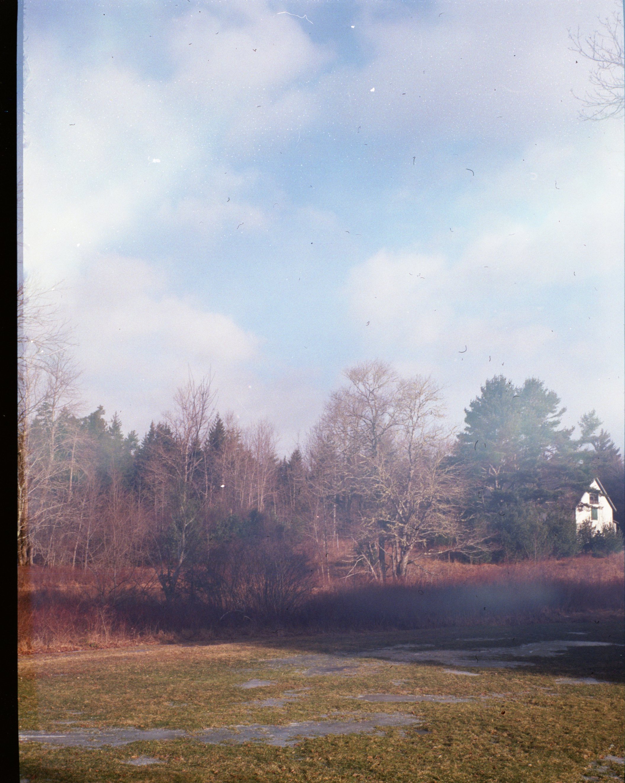

So I'm trying out a Zeiss Ikon Nettar 515 that I was just given. My focus is off, and there's dust to clean and I think the lens needs some compressed air. That being said, I've noticed a very strange artifact on the negative I just scanned. On the far left of the picture is a thin vertical band where the exposure seems considerably better. Most of the picture has some kind of haze to it. Any idea what's going on here? Not every photo has this band but when they do, it's in the same spot, about the same width.
Peltigera
Mar 11, 2012
902
Lincoln, UK
Well, you have discovered the best way to remove dust from inside an old camera - run a roll of film through it!
Yes, the image is very hazy. The haze is mottled which, to me, almost suggests poor development. It is not light leaking in. It might be easier to comment if you posted a photograph of the negative, including the rebate and gap between images. If nothing else, that will distinguish between film issues and scanner issues.

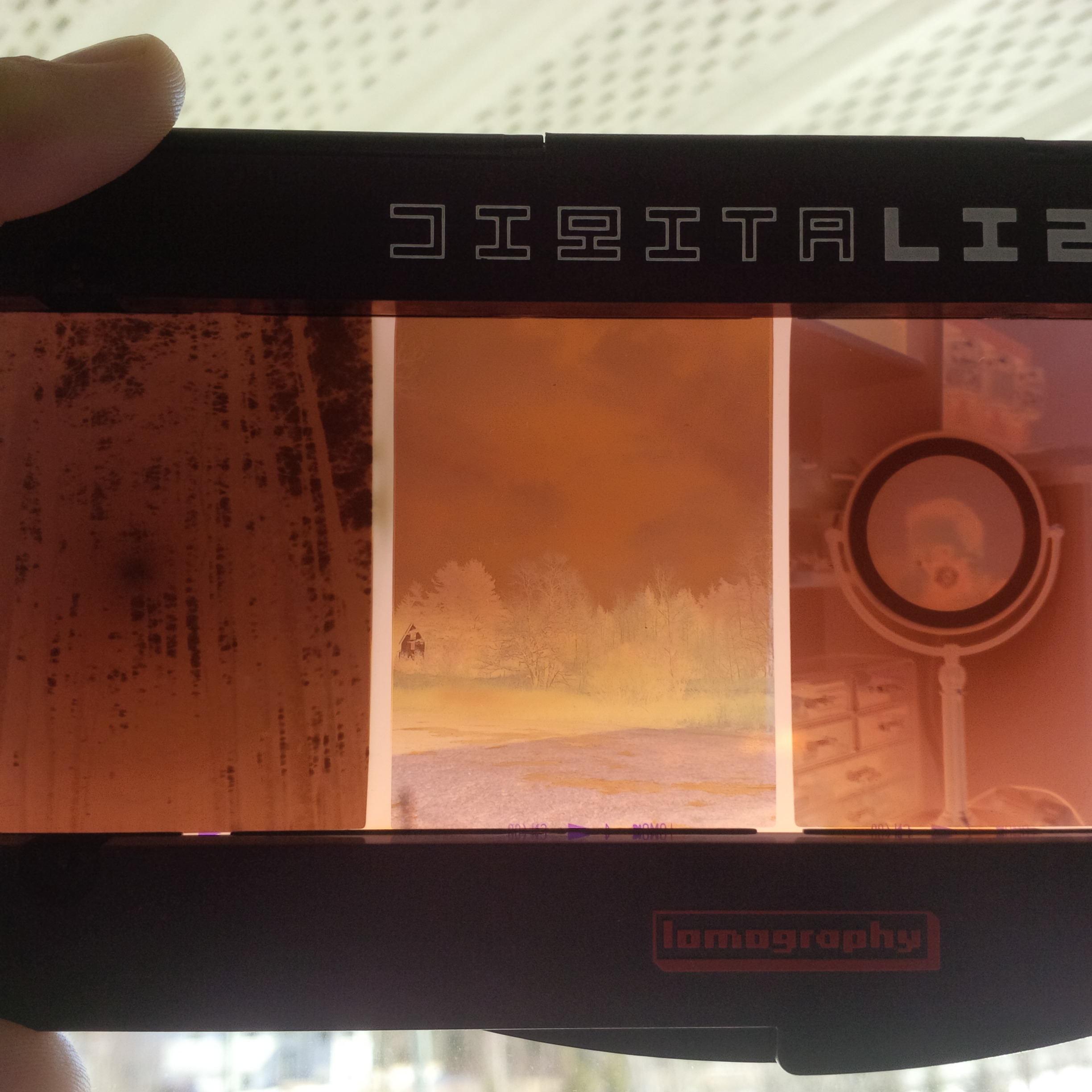

I will photograph the negatives tomorrow when I have some form of natural light to illuminate the photo. I can tell you that I can physically feel "water spots" on the negative. I can see the demarcation that I asked about above on the negative itself. The spacing between each photo is quite tight- only a couple of mm. I had one unexposed frame which has developed with that blue haze (which I will post below- this is a blank frame to be clear) which to me really makes me think something is truly messed up.

Here's a photo of the negative. Sorry for the quality...
center image, on the right side of the negative.

I think that is a development issue. Did youd evelop the film yourself?
Professional lab developed it. That being said, the last 3 times I've had anything developed twice my 35mm scans were misindexed and now this for 120. I do know they have let people go and also that their film processor malfunctioned. They were going to replace it but instead just repaired it. I think it's time I talked with the manager. I just wanted outside confirmation that it wasn't something to do with the camera this time. It is very old and new to me so I wasn't sure if the error was mine, the camera or the lab's.
