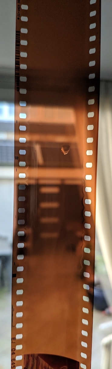

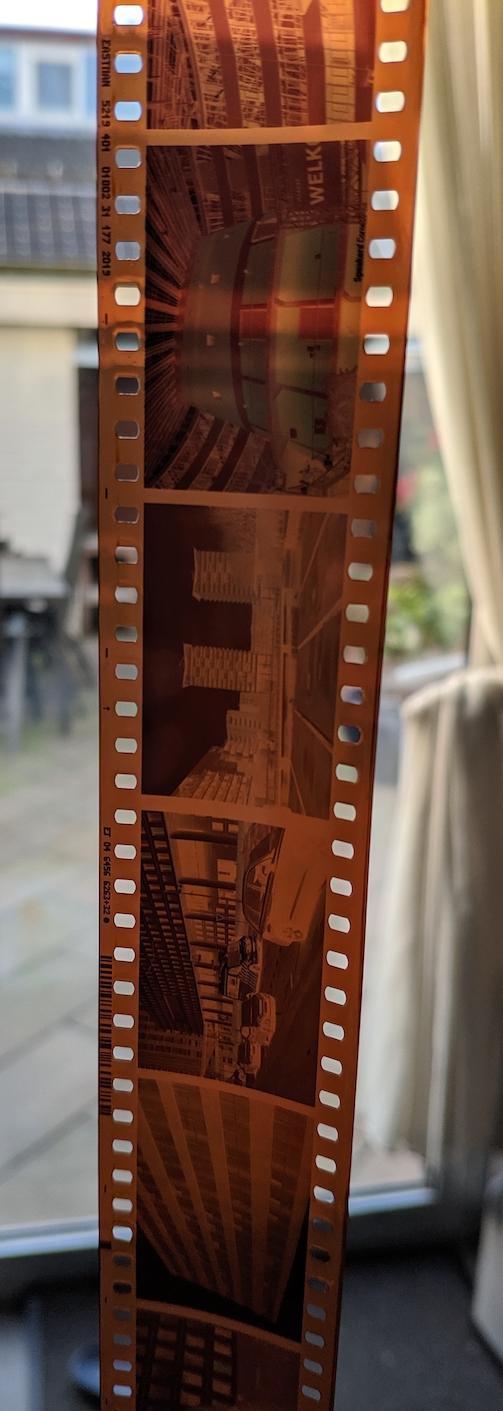

What caused these lines through my entire 35mm negative strip?

I directly noticed the issue when finished developing the film and let it dry. This was way before it ever hit the scanner.
Keep in mind there are no indents or scratches where the blue light is at, check the microscope pictures.
I've also scanned 20 rolls with this scanner and no problems like this has ever happened.
does it happen with more than one camera and one film, maybe there is dust or a micro-abrasive in your camera ( or if you are bulk loading your cinestill on the re-usable film canister or light dam felt of the bulk loader )? did it only happen with this roll / rolls of film? i'd take 2 strips of film out of your film stash of this particular film, one develop it unexposed and another just dimly expose to roomlight don't put it in your camera .. and develop them to see if it is actually in the film stock. or it happened when you developed+dried your film otherwise not sure what to say but if it only happens with this film don't use this film unless you want it to look like this? its kind of a nice effect to have in your back pocket !

Cinestill is MP film with the remjet layer removed, right? I think this might be remnants of remjet.
I think I've read it can be removed after soaking in washing soda solution.

Rests of the REM-jet layer would be visible in reflected light. And in transmissive lighting as black lines, thus added neutral density. Here we got coloured lesser density.
Yup, and they are dark lines in the non-inverted images the OP provided. It's a negative material. Yes, OP, can you see something on the back side of the film?
Yes, of course the other way round. (I really have a bad day today...) But still the remnants should provide a neutral image.
Just double checked but nothing, it really looks to be the emulsion.
Rem-jet should be on the outside layer right? Its not a internal layer correctly? Even checked with my nail and then rubbed my finger over a frame without success. (Frame had motion blur and was ruined even without light leak so nothing is lost)
REM-jet is a carbon pigmented gelatin layer on the backside of the film.
In the first image you see a crossing of lines. I do not see how such could be explained from ineffectively brushing off a backside coating.
Unless they managed to leave a very small rubbed down layer of REM-jet that I just can't see, its not on there.
Even in sharp light or underneath the microscope I don't see any layer left. Its inside the film, or so incredibly thin it might as well just be part of the base. However since rubbing it doesn't change anything I still think its just the emulsion that has been hit by light
Maybe incompletely removed remjet has somehow migrated to the emulsion side, most likely from another film that was laying on top of it while they removed it?
To me the pattern does look a lot like something that resulted from a wiping motion, but I cannot imagine how a light source/leak would have moved along the film like that. That coupled with the fact I've never seen such from a film that doesn't originally have remjet makes me want to hang on to the hypothesis a bit longer.
Well, adding a substance may explain that crossing of lines. As in brushing something on. (Though above I exluded a chemical being added, but then I was thinking of something low viscous.)
But what about the colour? That does not indicate carbon.
If the remjet wasn't completely removed by Cinestill, and lines of it were left on the film, then in the places where it remained there would be less halation and you might end up with more density there (and a blue tint).
Wouldn't everything be shifted toward blue to neutralize the orange mask?
I did use a squeegee
99% sure that's your problem. Dont squeegee.
The squeegee draws scratches in the emulsion, the scanner picks up plus density due to light scatter on the scratches. The disturbance of part of the orange masks results in weird colors.
Give it a try without the squeegee and see if that helps.
First thing already that speaks against a squegee caused artefact is the line structure. Just look at the last image, at the barcode. How could pulling a squegee over the filmstrip cause that wavy pattern?
Non-perfectly linear motion of the squeegeeagainst the film.
In the few times I erred in the same way and used a squeegee I got pretty much the same result.
If course other causes should not be excluded, but given the nature of this problem and evident issues inherent to using a squeegee on film I'd start with eliminating that variable.
Currently preparing to develop the other roll of cinestill (same batch, bought at the same time), this has 26 shots on it. I rolled the film back before I reached the end, so that part of the film has never left its shell until it is put in my tank.
I'm quite sure the lines were there before the squeegee, but I'll try not to use it this time. Maybe I'll only use it on the part of the film with frames on it (So its still comparable), I often get drying spots otherwise.
Give it a try; of course it could be something else causing it, mybe even beyond your control (a little mishap at cinestill).

Anyways, Just finished developing the other film and surprise: It looks to be ok!
There is some similar like colouring on the sides though, but I feel that might just have been my reel or over agitation? Not sure, but thankfully nothing is on the film itself :smile:
