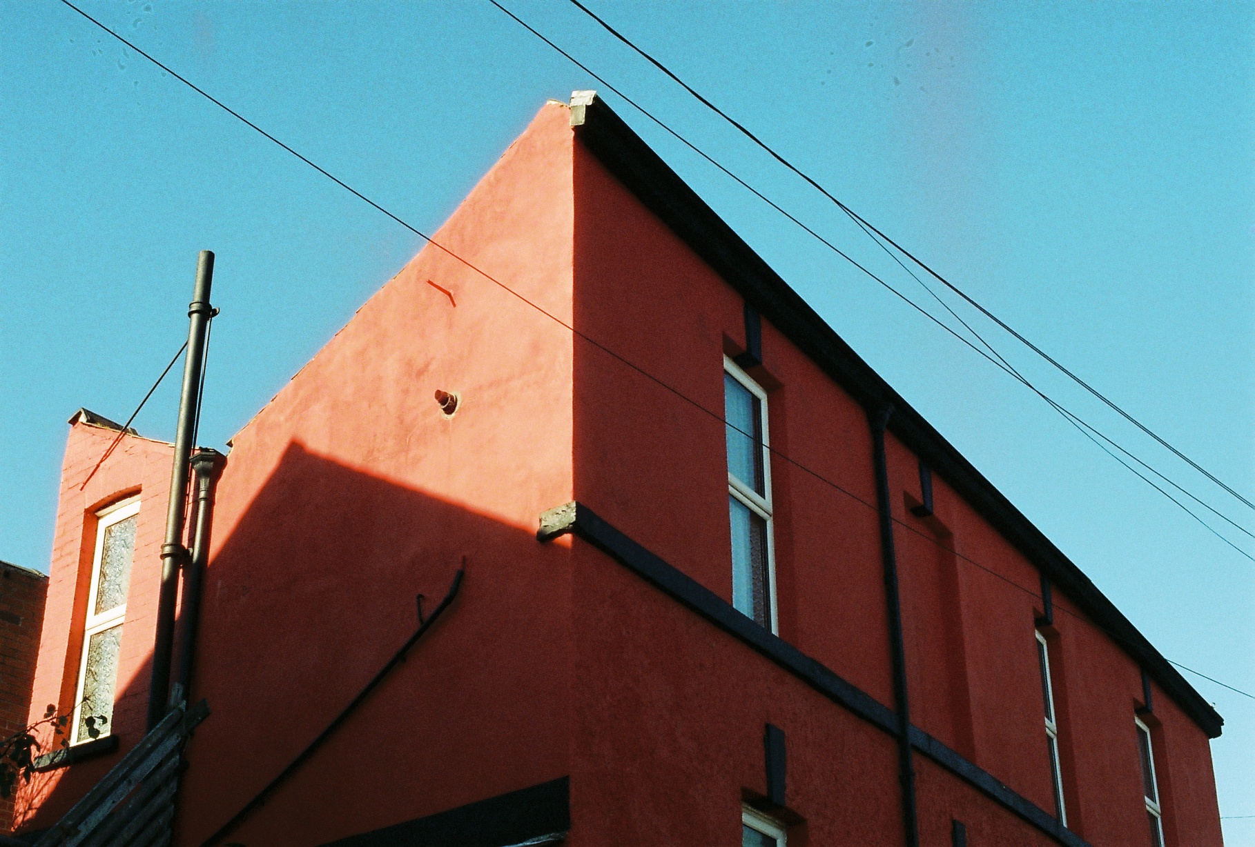

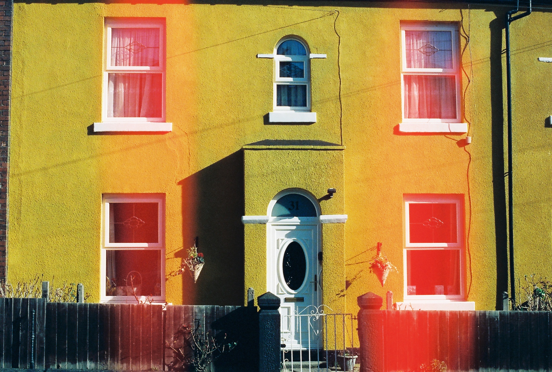

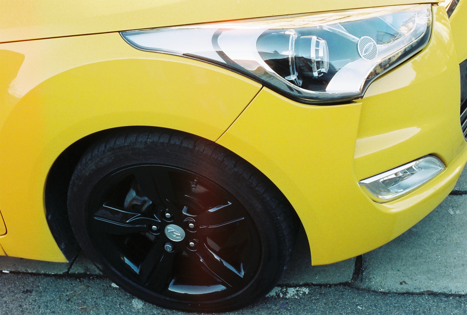

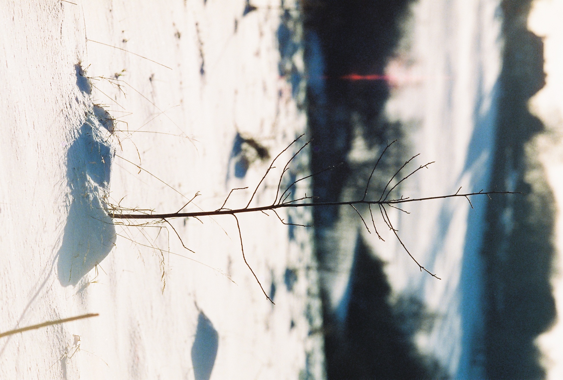

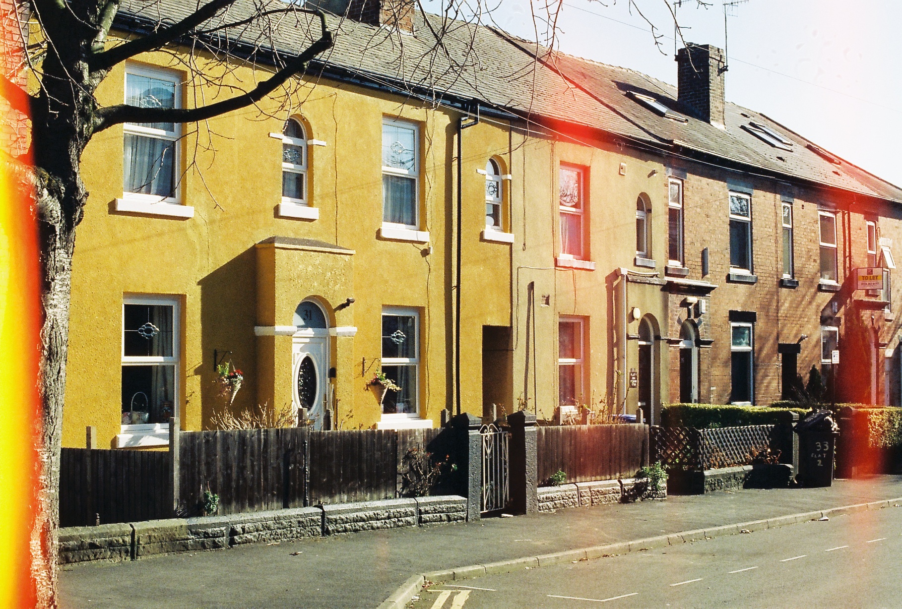

Could someone help me identity this light leak?
It only appears on the first 3-5 frames. I think its only happened when using iso 400 and 800. I've attached some pics taken with cinestill 800t. The light leak starts off really bad then decreases after those first few frames. Light seals seem fine. Unless its door not completely shut after loading. I got 37 from 36 roll. Once loaded you press shutter and it automatically advances the film, which sounds like 3 continuous shots.

That looks like a light leak through the opening on a re-used cassette where the felt is worn.
I would try a "normal" factory load film to see if that solves the problem.
Did you load the camera under a bright sun? Its definitely light struck through the felt slot.
A light leak at the back door window would affect the whole film, a leak at the cassette velvet not.
Yeap! This is lip fog. It does not exist in the later frames of the roll due to the light being attenuated almost completely after the first semi-opaque layers of the roll in the canister.
Replace worn cassettes and load film in subdued light.
