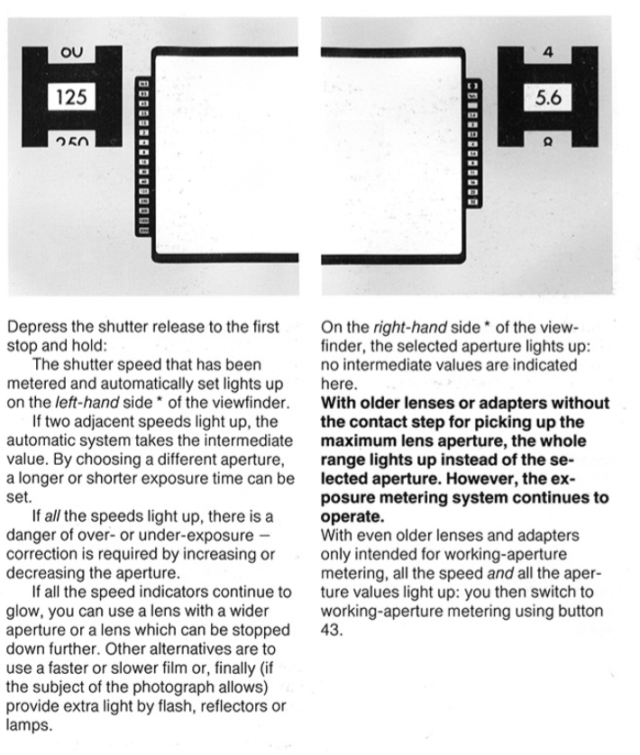

Rollei 3003. The manual is misleading because it actually is the inverse of what is shown. Illuminated red numbers on a black background.
