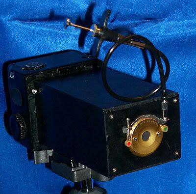

I went very simple on my 4x5, a bit more complex, including cable release, on the "SQhole" I used yesterday.
The viewfinder stuff can be a problem -- didn't give that too much thought until I started using the camera. My 4x5 has a wire frame contraption that provides a reasonable approximation. The Bronica rig -- oops! I may consider just putting a modest sized hole in another body cap to use for a viewfinder in the future. The body caps don't latch, they can be interchanged almost too easily. Yesterday I interleaved shots with the 80 mm lens and used it to set up the framing.
There might be enough details on my pinhole page to give you an idea for a cable released shutter. I found a 6-32 press-in nut (used for sheet metal assemblies) seems to work OK for threading the release into. If the lug is thick enough, it could just be drilled and tapped.
The SQhole, rev 2
Detail of Rev 1 (too small) shutter plate (You'd think with all that drawing I'd have figured out it was going to vignette - doh!)
The 4x5 The pinhole plate is clamped between the two pieces of plywood that made up the lensboard.
