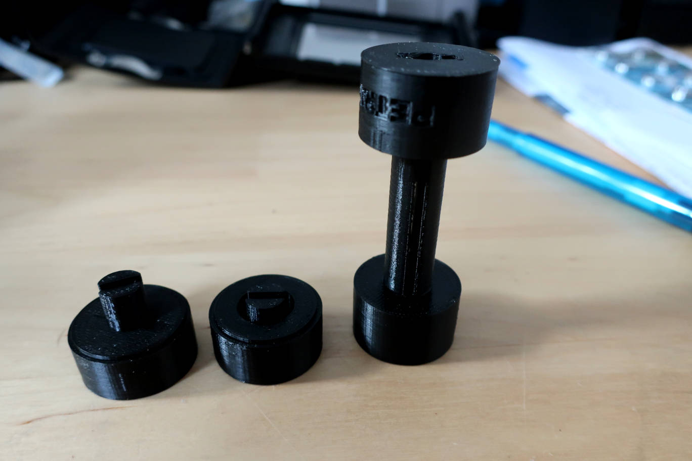

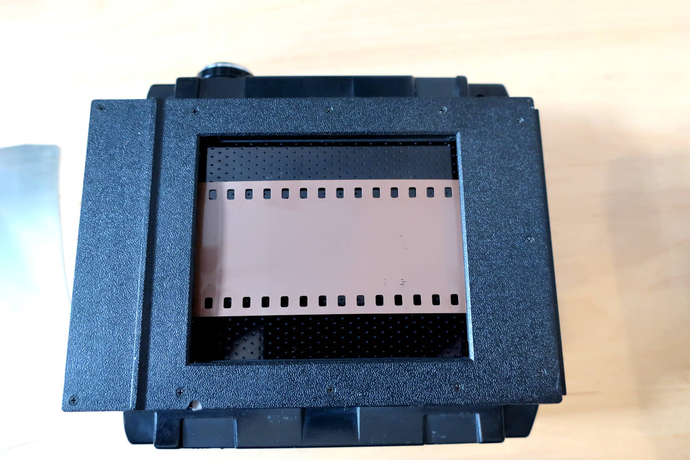

bought one on ebay for my mamiya rb67 recently. it works nicely.
some picture results

you get nice panoramic photos for less than $20 investment...

With the above two examples adapters, when you finish the last frame, how do you rewind or remove the film?
I see some adapter has the 35mm canister on the take-up side. But the above two do not have. I can take the film in the film back and rewind in a change bag. Or I could wait until development time and load the film directly to the reel. Hope it is not messy since 36 frame 35mm film can be long. I still get a change tent.

yeah, that kit pictured above will require that you open the back in the dark, pull the film off the takeup, then load it on the developing reel. You might simplify by opening the back in the dark, cutting the film off the cassette, then loading the film from the end first. You would have the same process if you used a 120 spool as the takeup. Some of the kits you can buy two of and load an empty cassette in the takeup, so you can remove the cassette from your back in the light and then later load the film in your developing reel as you usually would.
This brings up a point to remember. Since you need to use a camera geared advance (instead of the red window) those cameras are almost always designed to automatically feed past the leader on the 120 paper (or 220 paper). That means it will waste quite a bit of 35mm film as the mechanism thinks its forwarding to the beginning of the film. The trick I've seen is to have a premeasured film leader, tape it to the beginning of the fresh film, and spool it into the cassette with the fresh film. then attach the other end to the take up spool, so when you do the initial advance you only advance past the leader and a few inches of the fresh film.
That's correct - I just remove the back from my RB67 when done and put it in my bag, and later at home I open it in the dark and directly load the film into the reel to develop it. I actually have two 220 backs and adapter kits so if I am ever shooting a LOT I have the ability to shoot two rolls in one outing, although that rarely happens. I also do have a dark bag in the pack that I always have in my car, so I could also open the back and spool the 35mm back into the canister if needed.
I haven't tried rolling it from canister to canister so that the back could be unloaded in daylight. It seems easy enough provided that you tape the leader to the little bit of film you've left in the empty canister. The only drawback to that I could see is that often my last shot is on the very last bit of the roll, and that would get wasted if I opened the back in daylight to retrieve it.
