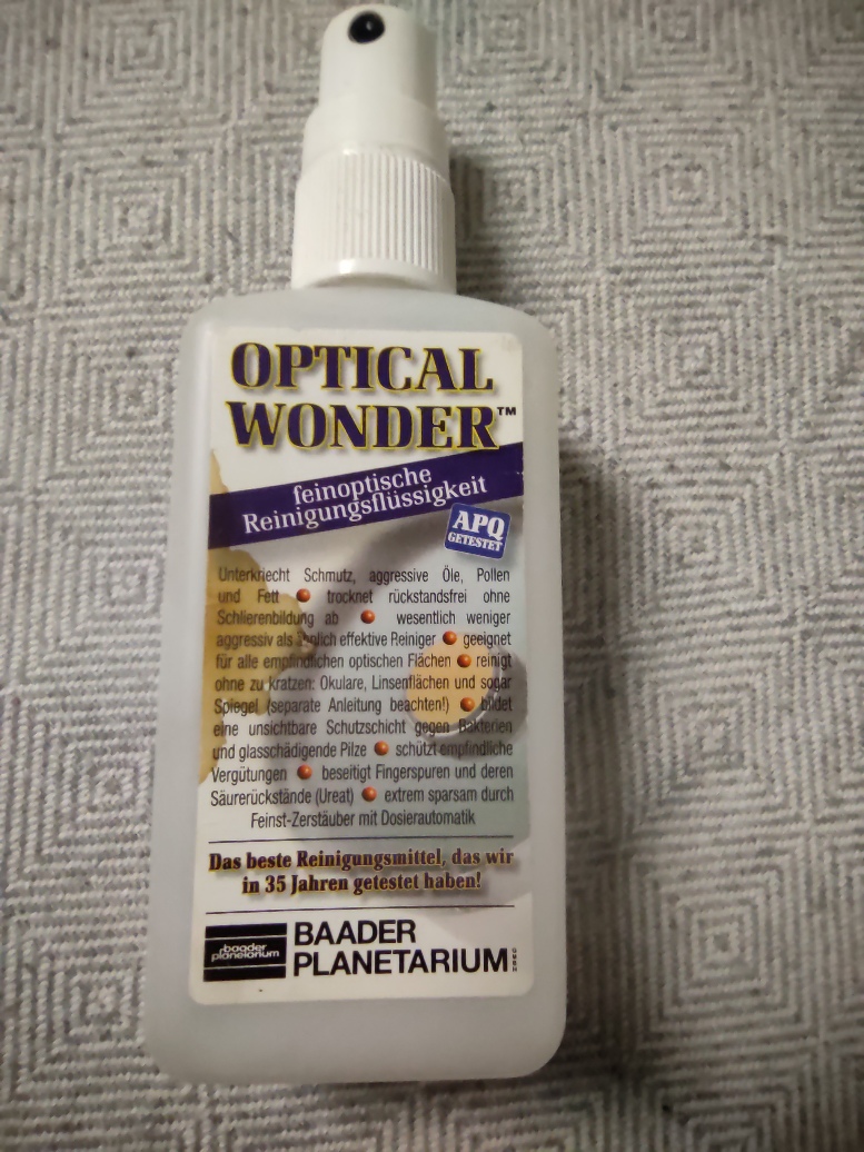

I have this and this does some wonders in cleaning...
