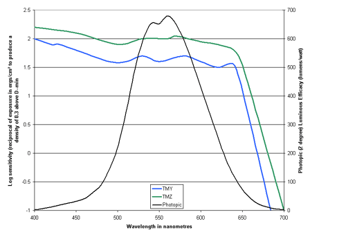

I hope that the graph is legible. It compares the CIE photopic luminous efficacy (in lumens/watt) with the spectral sensitivity of 400TMY and P3200TMZ (reciprocal of exposure in ergs/cm² to reach 0.3 above D-min, not a tungsten wedge spectrogram as used by Ilford for example). You can see the big difference at the blue end of the spectrum. (edit: I attached the wrong graph - this one is part log, part linear on the y-axes. I'll fix it later)
If incident (illuminance) readings were being used you could calibrate an industrial light meter for use with film if the light source was fairly consistent in terms of spectral distribution. You probably couldn't use the calibration in other lighting conditions.
Best,
Helen

Too late to edit and replace the graph. Here is a version with both vertical scales linear.
Out of interest I decided to have a look at what the ISO have to say about the spectral response of photographic lightmeters because I knew that they specify the calibration factor in terms of lux or cd/m², whichever is appropriate, not in terms of radiant power.
The ISO suggest that the calibration should be made at a correlated colour temperature of about 4700 kelvins – a ‘reasonable compromise’ between daylight and tungsten. The spectral behaviour of the meter is determined by comparing the meter with a meter conforming to the CIE standard (photopic) observer under two CCT conditions: 2855.6 kelvins and 4700 kelvins.
These are just ISO suggestions and not requirements and there is no need for manufacturers to follow them.
