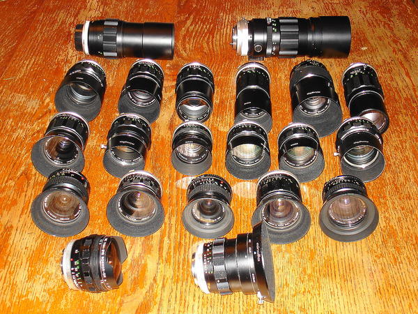

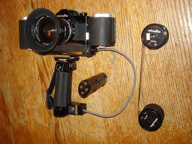

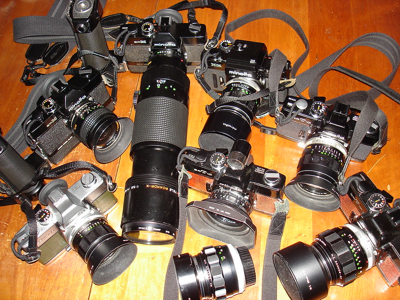

I have a few myself.........
The MD lenses will work better with your XD11 (if having all exposure modes is important to you).
I prefer the build quality of the older lenses myself. I have all the MCs but the 80cm F8 RF and the 100cm RF.
Plus a few MDs. They are all excellent. :smile:
