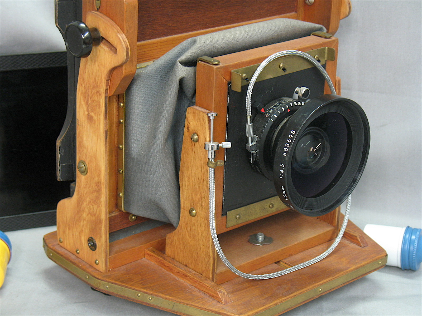

Back in 2017 I posted a peek at a 1993 homemade 6x17 contraption using a leftover 5x7 back to make two 6x17 negatives. It was my first foray into wide format...
It's a bit on the goofy side but it added a lot of great negatives to my archives.
Here's the story... two-617-negs-on-a-5x7-camera-built-june-’93.155715
