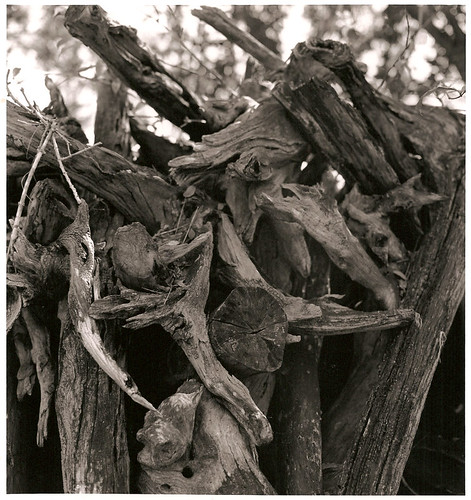

Well I went back for more practice today. I received a paper safe from eBay that had paper in it. So I chose to use the old paper since there was a stack of about 100 8x10 sheets in there. I used a #2 filter, only stopped my enlarger down to f/16 this time, and used the unknown paper. I made a few prints but this was my favorite from the bunch. Its because its from the first roll that I put through my new Hasselblad during my trip to Mexico last month.
WoodFence by ChristopherCoy, on Flickr
Christopher:
I am seeing progress :smile:
Keep having fun!
