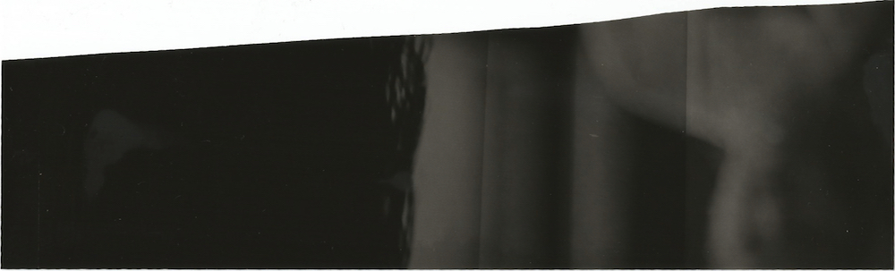

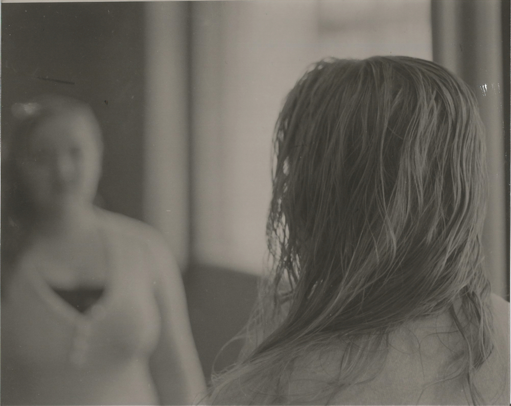

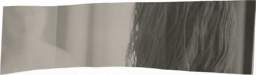

This is only my second go at this, and am pretty much having to figure it out for myself, so kinda need all the help i can get!
I had another go at doing an enlargement this evening, would have like to have a few more goes but was getting late.
This is just a quick scan of the print, and my test strips. The first one i thought looked to dark, so closed the aperture a notch, the print was 50 seconds.
It is much too grey, the dark bits aren't anything like as dark as they should be, but the light bits are grey too, this has me confused!
Also, there are a few botches or blemishes, are these dust or os there something else going on.
Lastly, do you use photo flo or whatever it's called on prints or is it just film?
You'll have to excuses the marks on the right, the damn line snapped as i was hanging it up. Good job i don't like it!! :pinch:

What type of film and film development are you using? Also what type of enlarger, paper, process and times are you using?
MattKing
Apr 24, 2005
53,339
Delta, BC Canada
One thing I note is that the scan of this you posted in the other thread is flipped. Which is the correct orientation? If the scan was correct, you should flip the negative over in the negative carrier.
I'm wondering whether you are having problems with safelight fog. Are you using an easel that leaves borders? If so, how do they appear?

Film is HP5 developed in DDX, cant remember what make the enlarger is.
The paper is Ilford Multigrade RC Gloss
Ilford multigrade developer for 1 min, stop 30sec, fix 1 min and wash
The easel does have borders, but i don't like the look of them much so filled the paper. But... When i used the enlarger last time didn't have any issues like this.
You know i cant actually remember what the proper orientation is :unsure:

I started printing recently too. Easy mantra to remember is that exposure controls the highlights and contrast/paper grade controls what happens with your shadows (the opposite to the old mantra about how to expose film). To get a result that is more black and white than grey you will need to print at a higher contrast grade, you only need enough exposure to get highlights where you want them i.e. less exposure gives more white stuff. I have ended up needing to filter onto multigrade paper at anything between 00 and 3.5 because I have a mixture of negs way overprocessed by a lab, and others done by them or myself with OK negative contrast so I am rapidly getting the feel for this exposure and contrast thing.
Matt makes a good point, the borders should be paper white if held under the easel blades during exposure.

Well for a start you should increase the paper development time by 30 seconds, but may I ask what your print developer dilution and temperature is?

To get the blacks you want you will be needing more contrast.

You should look at the print NOT the clock when developing a print. The print will tell you when development is finished. Here are the steps that a print experiences.
Development To Completion
1. The induction period where nothing seems to be happening.
2. Linear portion of H&D curve. Density more or less follows elapsed development time.
3. The linear and shoulder portions of the H&D curve intersect. Here changes in density slow markedly but contrast still increases.
4. Well into the shoulder where over-development and developer fog become evident.
If you pull the print in Stage 2 contrast will be low and blacks weak and muddy. This is where most beginners screw up. It is very difficult to judge a print under a safe light. It will look good when it is not. So don't watch the clock but observe the changes in the print. However once in the shoulder development is complete and the print should be removed to the stop bath. When you become familiar with the method you will know precisely when to stop development.
The above method also compensates for developer temperature. I have used it at 65F to 85F with excellent results.
If you are still experiencing problems you need to look at film exposure and development for the problem. The same method described above can also be used when developing film by inspection.

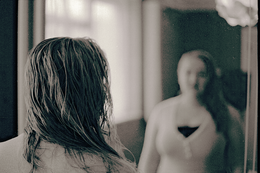

This is a low res scan of the print, if i could get it close to this, maybe a smidge lighter, i'd be right chuffed!

Your negatives may be under-developed, leading to low contrast, leading to a grey print.
But I would suggest an easel and a check of the borders, along with a safelight test.

So, if you overexpose the paper, and it comes up dark a bit too quickly, you cut development time from 60 sec to 40 sec to compensate for the overexposure?! No. The process control specifies a time at a temperture for a reason, and one should have reasonable process controls established. Paper is processed by inspection, under a safelight, and 'to completion', normally at the recommended time and temperature to obtain the appropriate D-max and get the full tonal range. Do not attempt to pull a print before it is completely developed in an effort to control density; the resulting print will be flat and muddy with uneven development.
The photos of post #1 looks overexposed and underdeveloped. There are no blacks. Full development time allows blacks to come up fully, but also for almost-highlight areas to still be close to white but with detail. Some developers, those with higher percentage of hydroquinone, are relatively high response to elevated temperures, while developers with more Metol are not so responsive, and manufacturers seldome publish time-tep charts for paper developers, so it is best to use 68F as the target temperature.
The later photo looks much better for blacks, but if her hair really is off-blonde, it is too dark in the print and a higher contrast grade of paper (or variable contrast filter) is needed to get shadow areas deeper without also getting midtones so dark.
