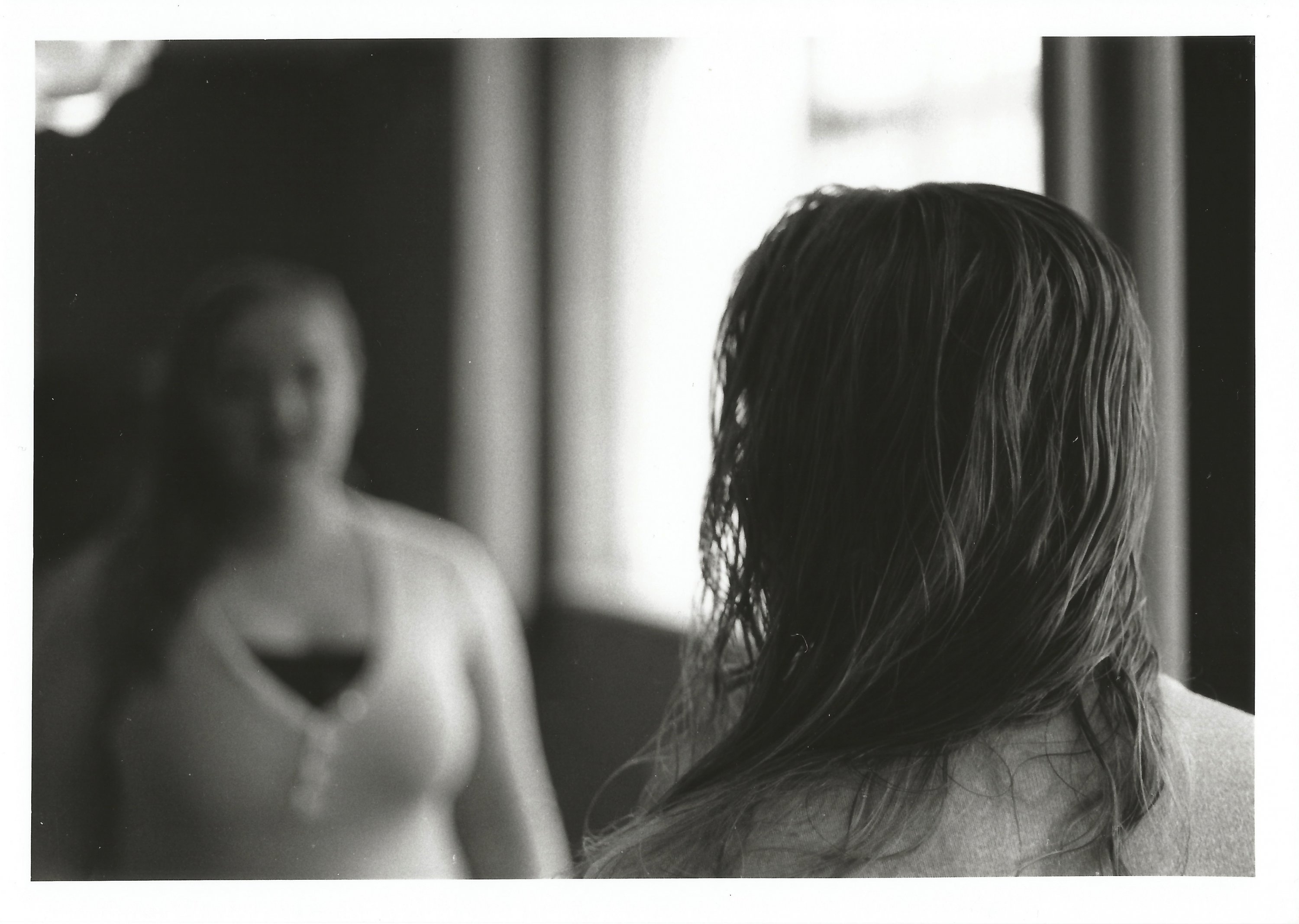

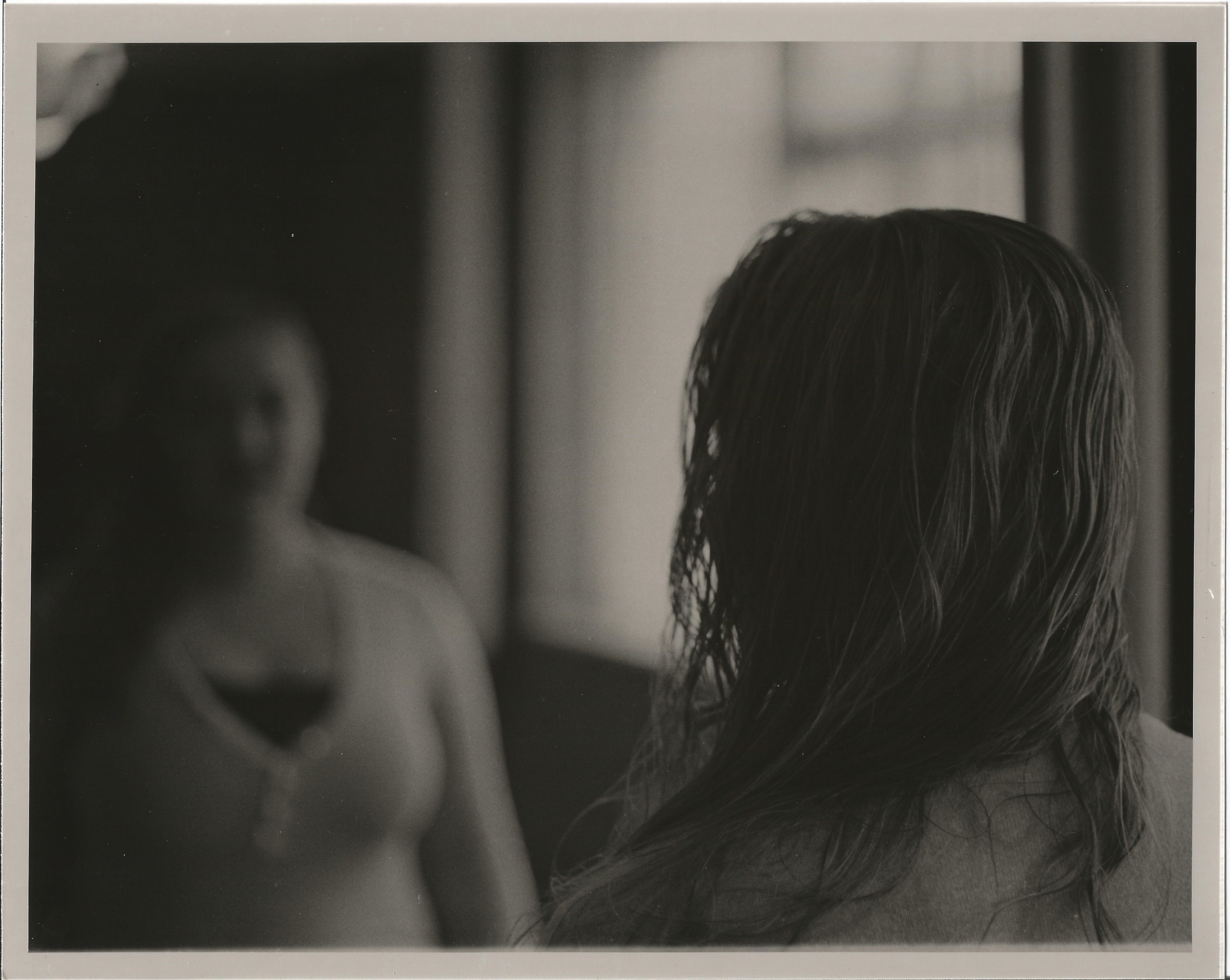

I had another evening in the darkroom, not as long as i'd like but better than nothing!
I did a few of the experiments that were discussed, it soon became clear where the issue was.
The paper i used last time i bought second hand, i knew it was a bit on the old side and a bit of a risk, but it was also REALLY cheap so figured was worth a punt.
It very soon became apparent the issue was with the paper. I also had a brand new pack of 5x7 Kentmere, when i tried that the difference was obvious.
I did lots of tests using different filters, found a Kodak exposure scale thing and boy did that make things easier. Discovered the little swing in filter could be popped out its frame, then i could just rest the graded filters on top.
I had to go all the way up to #5 to get anything reasonable out of the old paper. It's not too bad imo, but there is no proper white in the highlights, plus one look at the border gives it away!
The print on the new paper was done with a #3.5 filter, I'm VERY happy with how it came out :smile:
If anyone knows how the old paper could maybe be recovered, i dunno, different developer or something that'd be awesome! I've 400 sheets of the damn stuff so be a real shame for it to go to waste, though i've not tried the second pack yet, it's a different make so might fair better...
Moral of the story, don't skimp on paper!

My biggest fault i think would be it looks a little too soft, i'm wondering if the focus was a bit out?

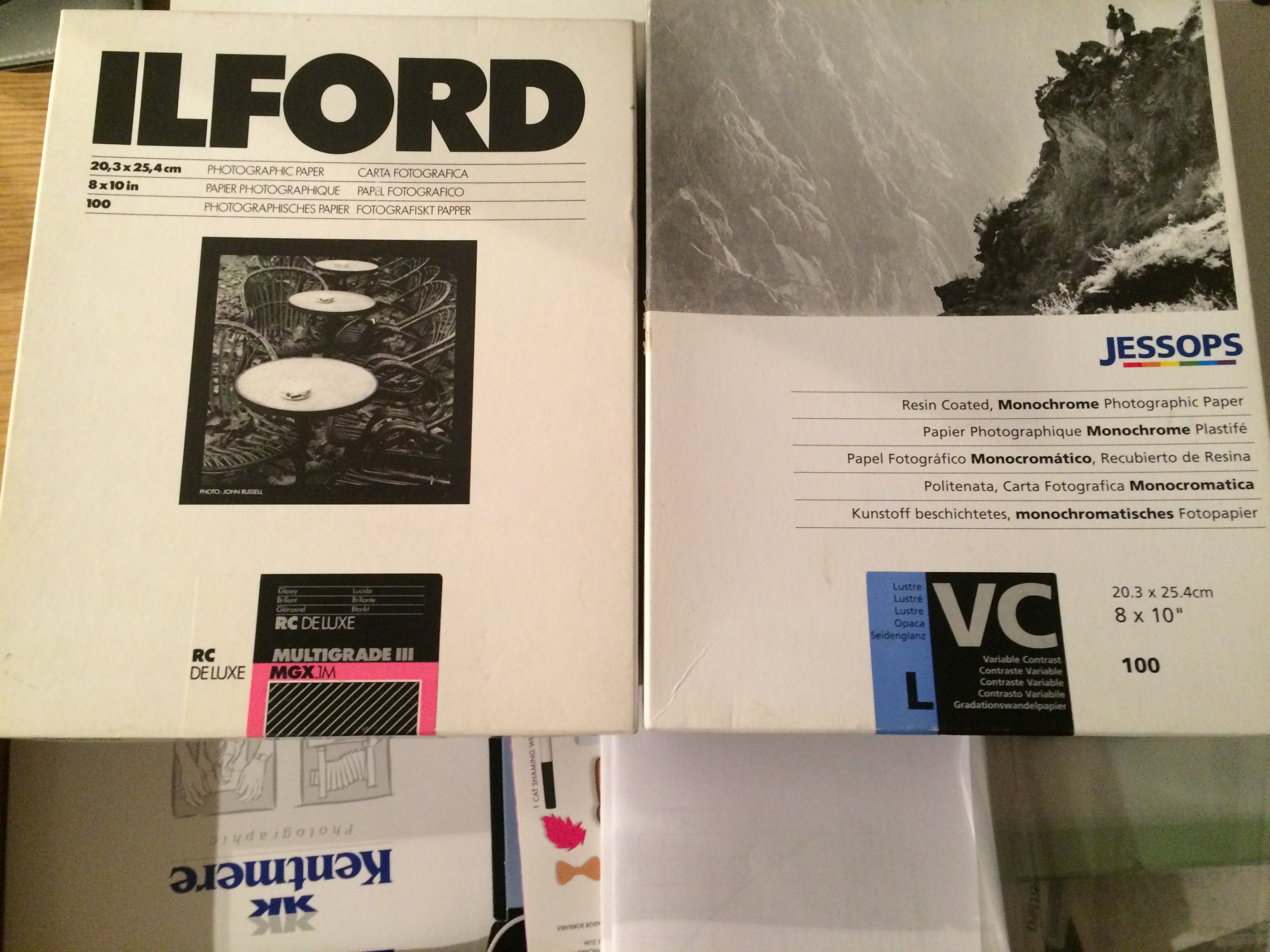

The old paper used above is Ilford Multigrade
Show us a picture of the package/box labeling, so we can get a sense of which version, and therefor approximately how old it might be.
If there is an indication of who produced it (Ilford Imaging or??) please include.
If it is Multigrade RC III, it is old.
Pic below... Indeed it is Multigrade RC III hopefully the Jessops will be better!

This is what i noticed, i had to go all the way up to a #5 filter to get the contrast, but the fog just ruined the highlights.
It might well prove itself more useful for experimenting and just general messing about.
I do have a bog box of brand new Kentmere 5x7, that is what the better looking print above was done with, the difference is HUGE

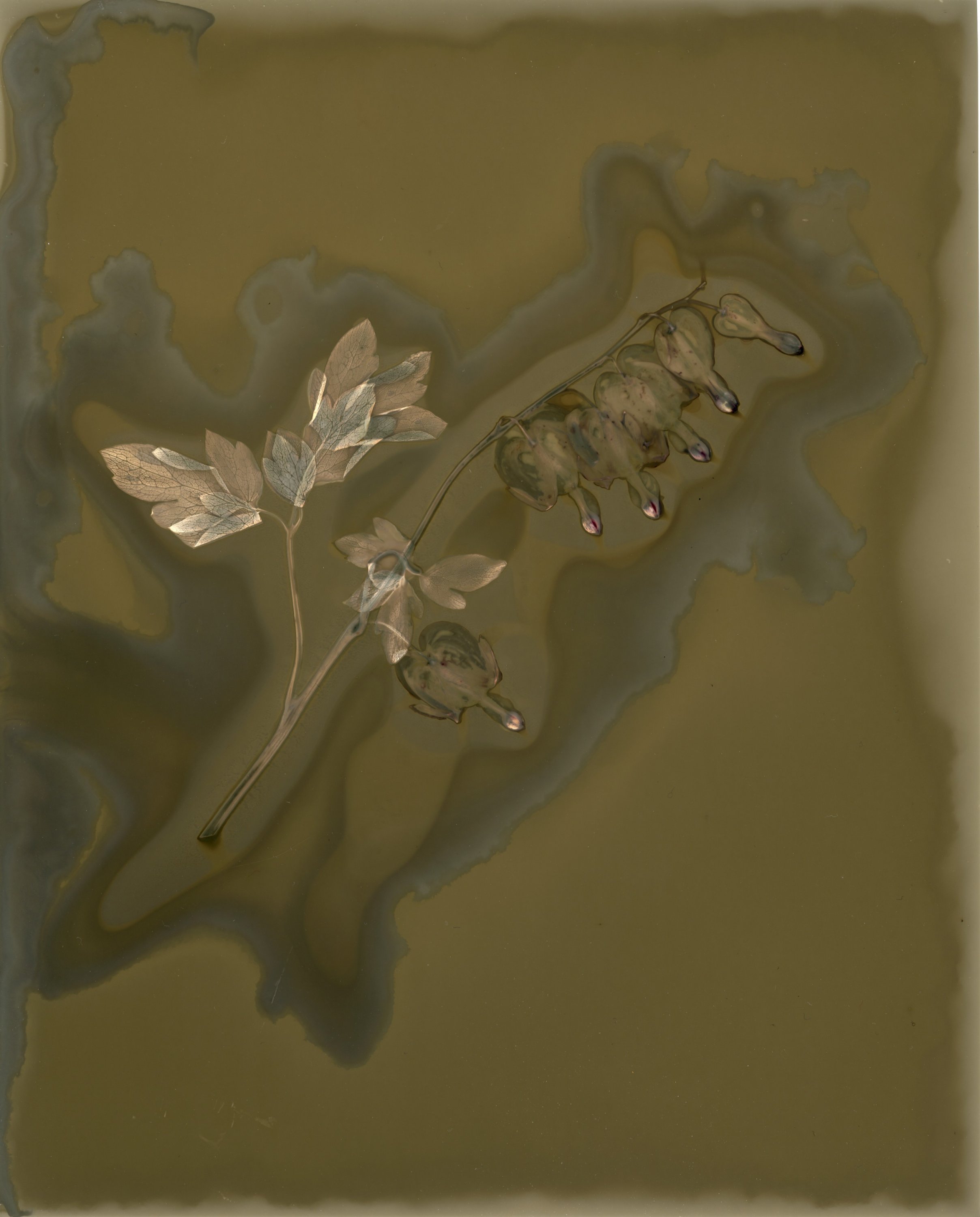

You can of course use out of date and fogged papers for 'Lumen prints', which is basically placing items on the paper and leaving it all in the sun, to which you end up with COLOUR prints. It's something I've read about a lot and also having some very fogged and old paper, I am looking forward to trying it when the sun / summer arrives. :smile:

Intersting, VERY interesting!
Very much so - that's why I also want to have a go with my 1. out dated and 2. probably fogged packets of paper that I've picked up cheaply, bought especially to do things like this with.
Not sure if there's a folder to put pics like this in = note to self to have a look.
