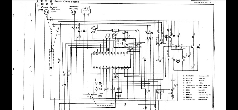

Some time ago I sent the circuit diagram for the Nikon MD-4 Motor Drive to an electronics engineer who is particularly well-known in Germany.
I wanted to know whether a practitioner with a lot of experience who also develops circuits commercially could read the electronic function of the motor drive from it.
I was surprised that he couldn't.
He recognized some of the components, but how they all work together as a system was unclear to him. To be fair, I must note that he is not a photo technology specialist,
The IC in particular, that rectangle in the center of the circuit diagram, probably an undocumented Nikon product, makes the circuit a mystery.
I knew that, but it's still astonishing that even the grouping of known electronic components didn't help to understand the electronic processes in the motor drive.

That's why the circuit descriptions in the manufacturers' repair manuals or the articles by Larry Lyells in The Camera Craftsman and SPT Journal are so important.
Only then can you get a more detailed insight into how the electronics of a photographic device work.

Very good, then I don't have to be sad when I try again to understand some of the circuits of my favorites.

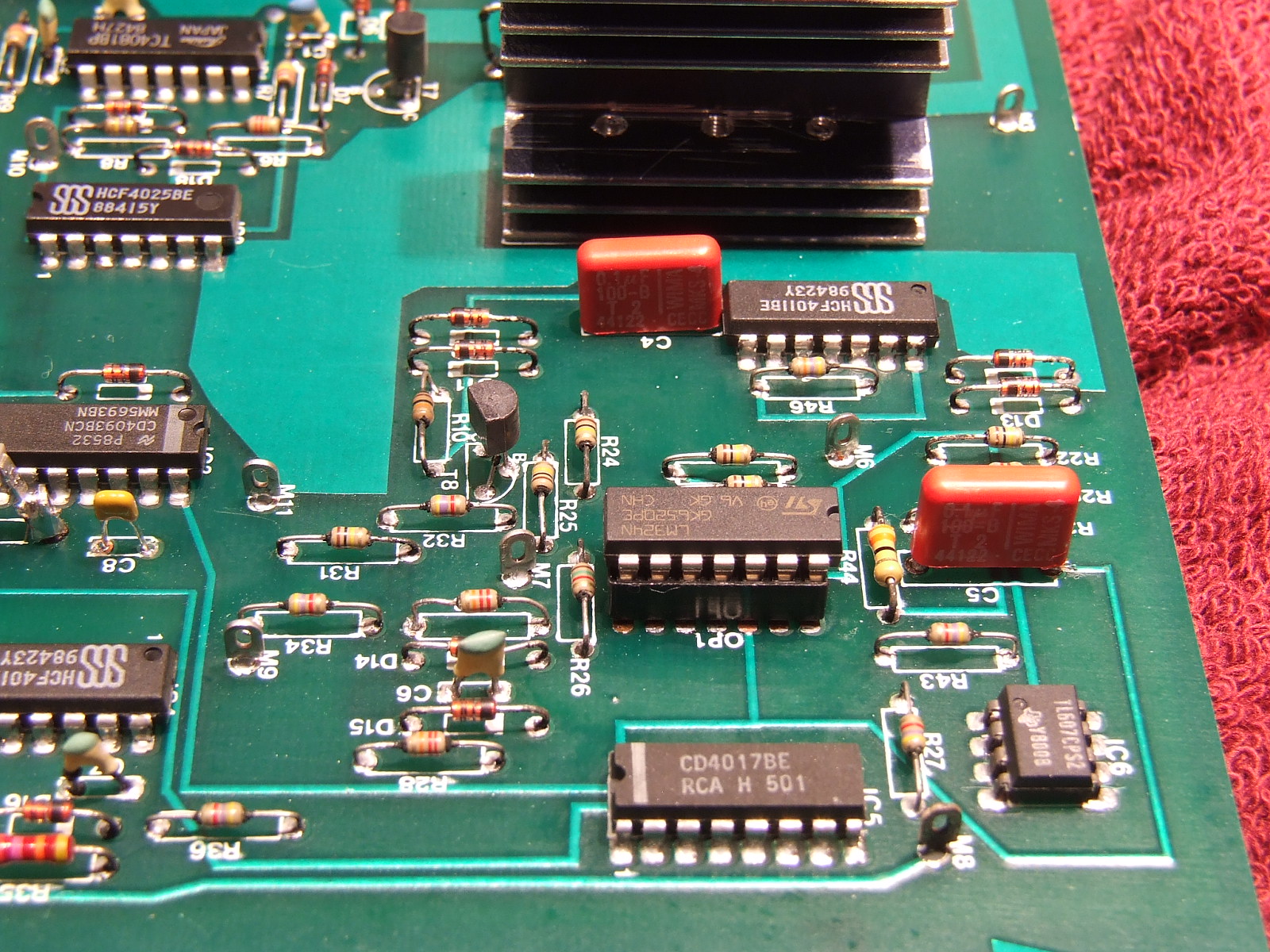

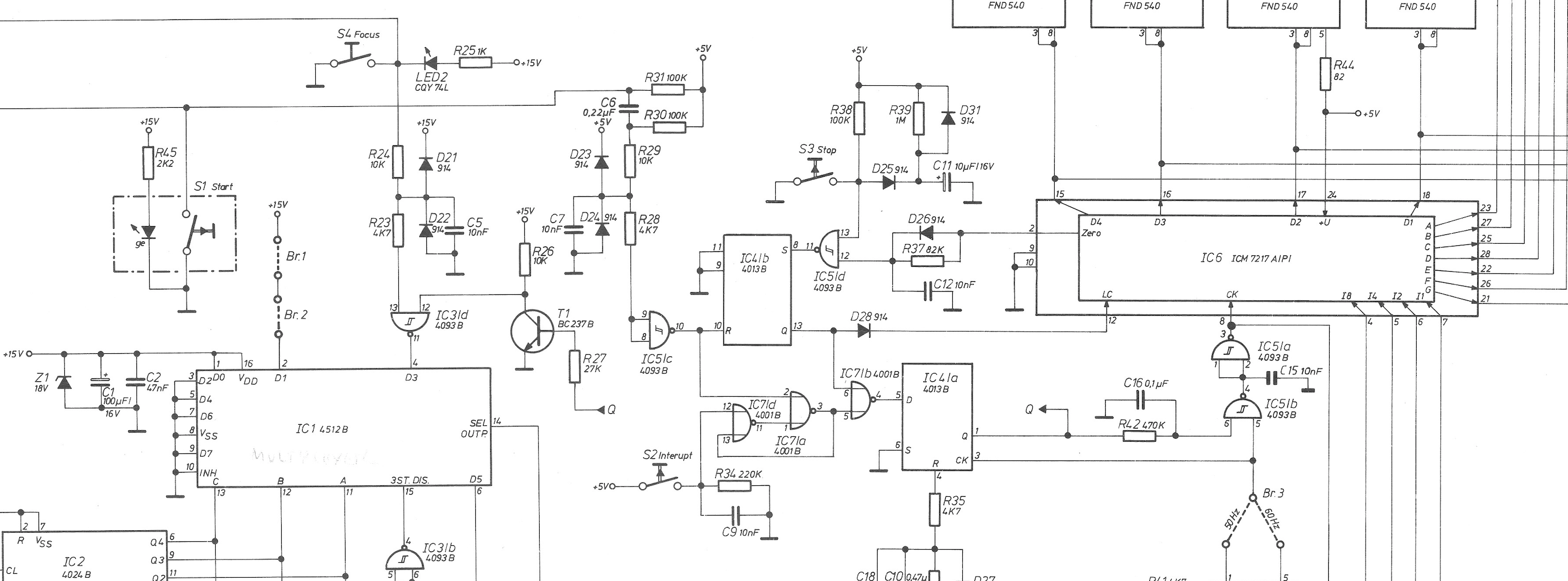

I had already made my own schematic for my Durst power supply before the original schematic arrived from Durst. I had the same experience, as all the ICs were left as blank boxes. Whereas my schematic included the functionality of the ICs. Fortunately the 1980s design used all 'off the shelf' components and nothing custom made for Durst. So I was able to download the tech sheets for all the components.
