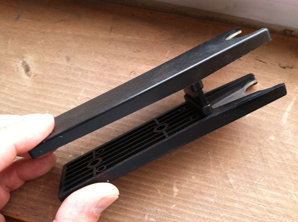

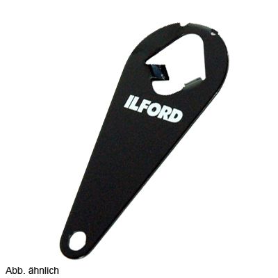

If you think that it's hard to open the cartridges in the darkroom get a cartridge opener like these:
or
