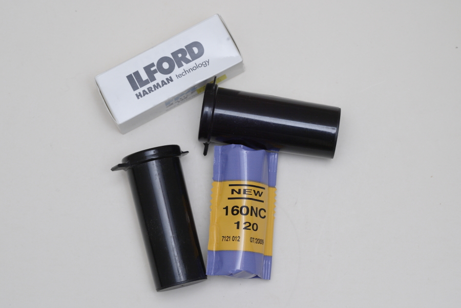

For 120 its obvious when a roll is exposed but I keep them in these black cans you can get from Freestyle
