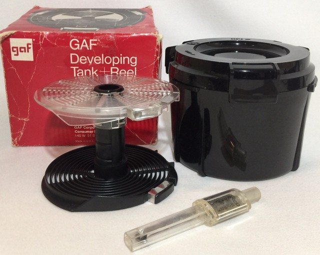

I'm surprised that Jobo put that on their website. The source for their warning might be a warning by Gigabitfilm on this issue.
