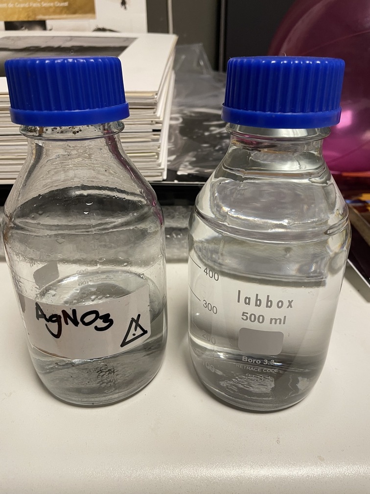

I have two 1 litre glass bottles that are 7-8 years old (from 2015) that I last used for the wet plate collodion process (see attached pictures) :
1. One is labelled AgNO3, so it is clearly a silver nitrate solution. I can see some black dust at the bottom. Regarding this bottle, my question is : Given the price of silver nitrate, instead of throwing it away, can I still sun + filter it and adjust its density so that I can still re-use it ? Or Would you consider it to be too old ?
2. The other one is full of a clear liquid, but it is unlabeled. It is very likely simply some water, but it could be silver nitrate as well (despite there is no black particles in it...). Do you know any very simple test that that I could make to determine whether or not it is silver nitrate ?
Thanks !

For #2: Put a drop into a bit of tap water (or salted water to be sure) and if you see white precipitates or haze formed, it may be silver nitrate, if none, then it is definitely not. If it does turn white, leave it in the Sun - it should form black particles if the original liquid was silver nitrate.

Thanks. The test w/ salty water makes sense !
Certainly! Silver nitrate also in solution is very stable. Your bottle shows no signs of deterioration of the solution. It doesn't look like it even needs any sunning. Just check density and replenish if necessary.

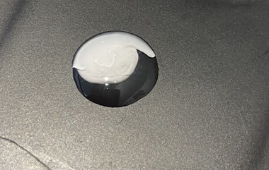

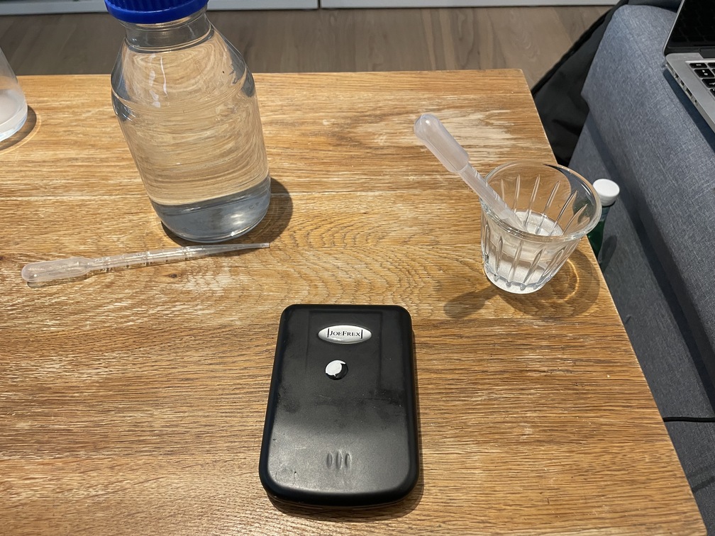

When I opened the unlabelled bottle, a small smell of alcohol came out, which made me think that it was probably not just water...
I then did your test, which was very conclusive: immediate formation of a white precipitate (see attached pictures). It is indeed silver nitrate.
