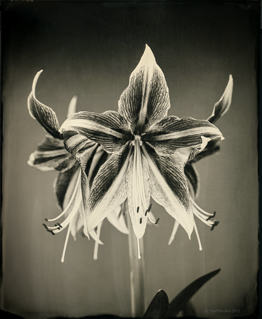

This is a new piece I did last night: a wet plate collodion image on aluminum, 7.5" X 9.25", using Old Workhorse. Camera: Deardorff with the Ektar 12" lens, 2 minutes exposure at f16.
8X10 tintype, Deardorff with the 15" Lerebours et Secretan lens at f5, 110 seconds exposure on Old Workhorse.

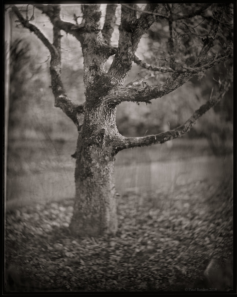

This is the first glass collodion negative I made with the Intrepid, fitted with a 1930s Kodak 5.5" Anastigmat lens (from Blue Moon Camera in PDX). While its not a great negative, it does show some nice texture and demonstrates just how sharp and capable the Anastigmat is!
Coffer's #7 negative collodion used, in conjunction with John's developer for negatives - well seasoned with used developer. The negative was intensified using John Coffer's intensification method, which I must say works beautifully. Exposure was 6 minutes at f6.3
