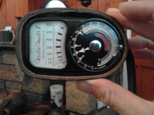

I have just brought a Weston master 2 from Ebay to use with my old Cosmic 35m, I have been using the sunny 16 rule ie the symbols on the camera with good results but wondered if I could make them even better. Using a camera set at f11 at 200 ASA It gives me a exposure speed of 15 to 30th of a second the meter gives me a reading of 1/400 of a second (I'm obviously doing some thing wrong !. This is what I have been doing I have set the film speed to Weston film speed of 160 which I am led to believe is there equivalent of 200ASA Pointed the meter ie: by pointing the back of the meter at the subject (there was a description which read keeping the meter parallel to the ground take the reading which confused me because then I would not be reading the light reflected from the subject !) I have took the reading in this case 300 (is this an actual known measurement of light or just Westons ) Rotated the dial till the arrow points at 300 then took the speed by matching what is next on the dial to f11. Can anyone see my stupid error ?
I take it this meter does not read reflected light but is just reading general light levels ! I must admit i haven't seen many light meters but the all of the ones I saw my Dad use needed to be pointed at the subject.
Nope - you take reflected light readings with a Weston Master II (not Master 2).
The back of the meter points toward the subject - but you hold the meter with its side parallel to the ground.
It is all described in the manual - which is easily found on the internet.

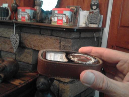

Using it the first way means the cell faces the floor the second gives very high readings not matching the Cameras light meter
Holding it the second way is what the manual means when they describe holding the meter "parallel with the ground".
They are trying to discourage people from holding it with the scale pointing to the sky.
Thanks Matt much appreciated, I think I'll have to stick to the sunny 16 rule as the readings make it impossible to use. The camera does not have the capability to use those settings and if I did it would mean a massive under exposure according to the other camera and the settings I would have used down to experience.. If nothing else it looks a nice bit of kit.
