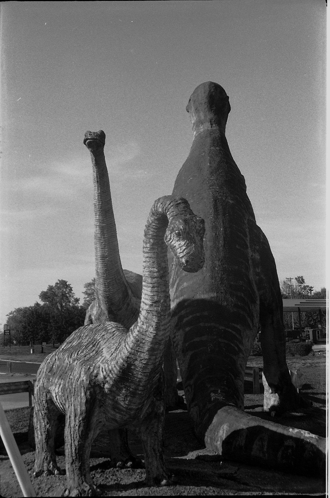

This is the Weltini II and, obviously not Ektar film!
Seems the viewfinder is fairly accurate on this camera, and I had to back-pedal a lot further than I thought I would for a 50mm lens. Makes me think the effective focal length is longer than 50mm for sure.
I had a lot of problems with shutter speeds dragging, the advance release hanging a couple of times (breaking perfs twice) and leather fibers from the disintegrating case migrating into the bellows. What few shots I could salvage were pretty decent as far as lens performance, but it would have been much better if I had developed the Arista EDU 100 in XTOL or some other lower contrast developer rather than D76 1:1.
I had to do a lot of work with curves to salvage the dino image; it was about 2 stops over exposed. Seems the longer I shot with the camera, the slower the shutter cycled.
It stands to be a good camera, but I have a lot of bugs to work out before I can call it a daily user.
The Exchange Hotel Civil War Hospital in Gordonsville, VA. Dinosaur Land in White Post, VA.
Not too shabby for something this old.
