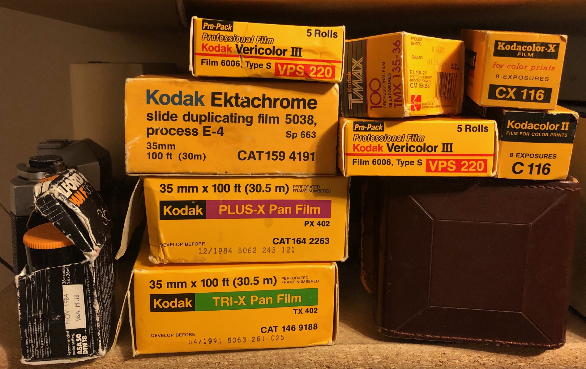

Like others, I’ve ended up with expired film. The photo shows some of it. One of the 5 packs of VPS 220 is unopened but expired in 1986. The C116 expired in 1975. The Ektachome slide duplicating film expired in 1977. I might shoot some of it but maybe not. The Ilford will at least be worth it for the reusable canister. Then again, I have oil filters for cars I no longer own.
That Ektachrome Slide Duplicating film is E4 process, not E6.
If you send it to an E6 lab, they will have a BAD DAY.

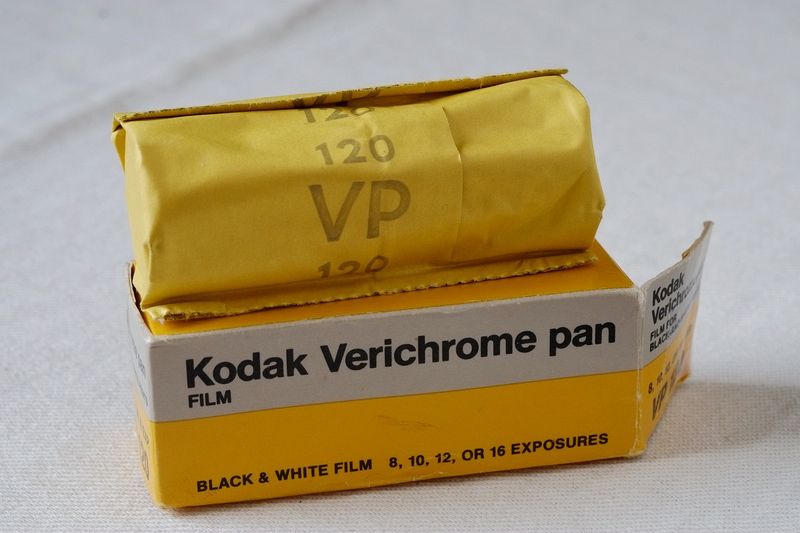

I shot the open-box roll of Verichrome Pan (exp. November 1997) this morning, in the Holga with defective aperture (always on cloudy, regardless of switch setting).
Weather was cold, 30 F, skies were extremely gray due to the impending blizzard.
I used one of the cardboard tricks to add tension to the take up spool and it was found to be tightly wound when removed.
I don't think it's a candidate for push/pull processing, since the Holga doesn't have a film speed setting. But if any of the pictures taken, actually come out, I'll upload some.

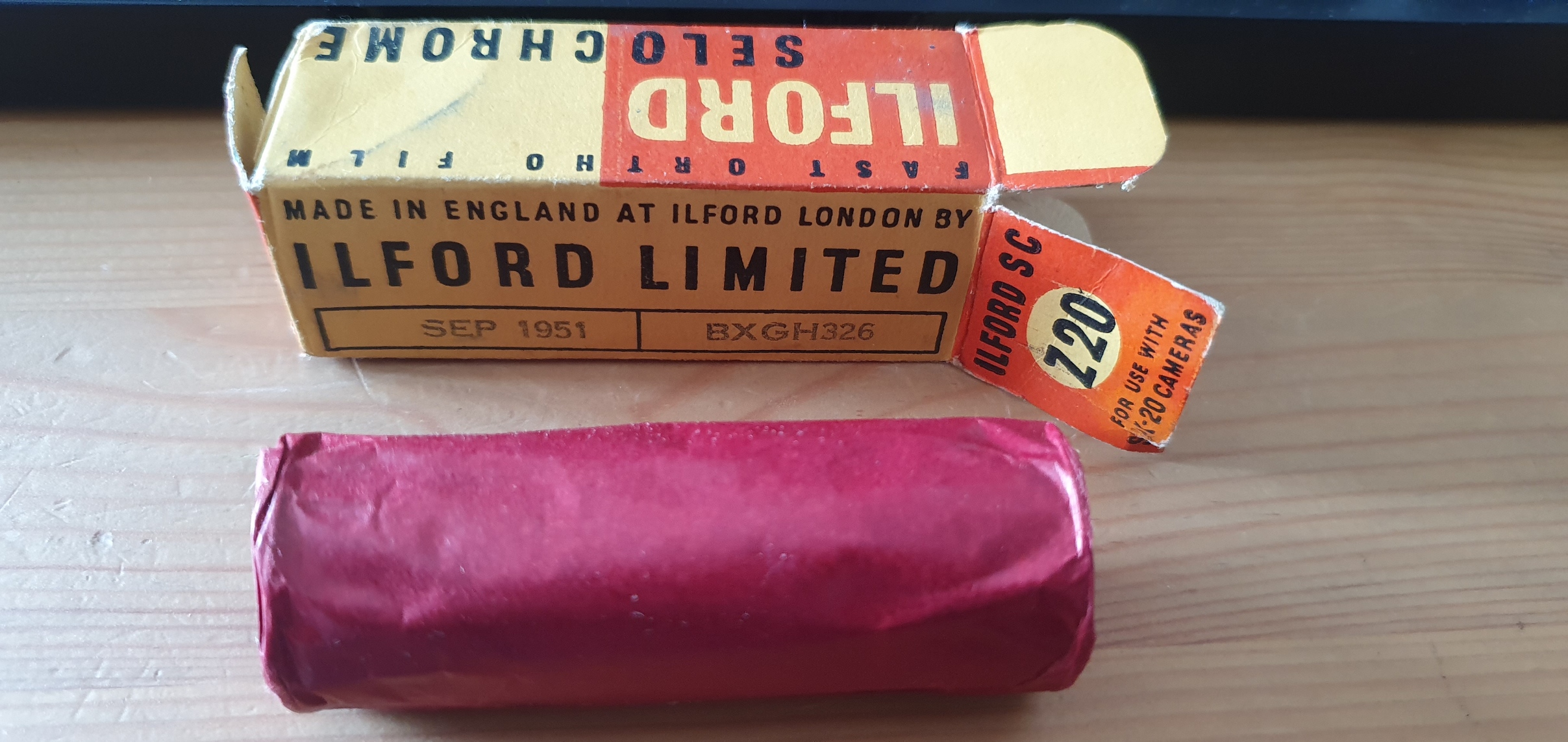

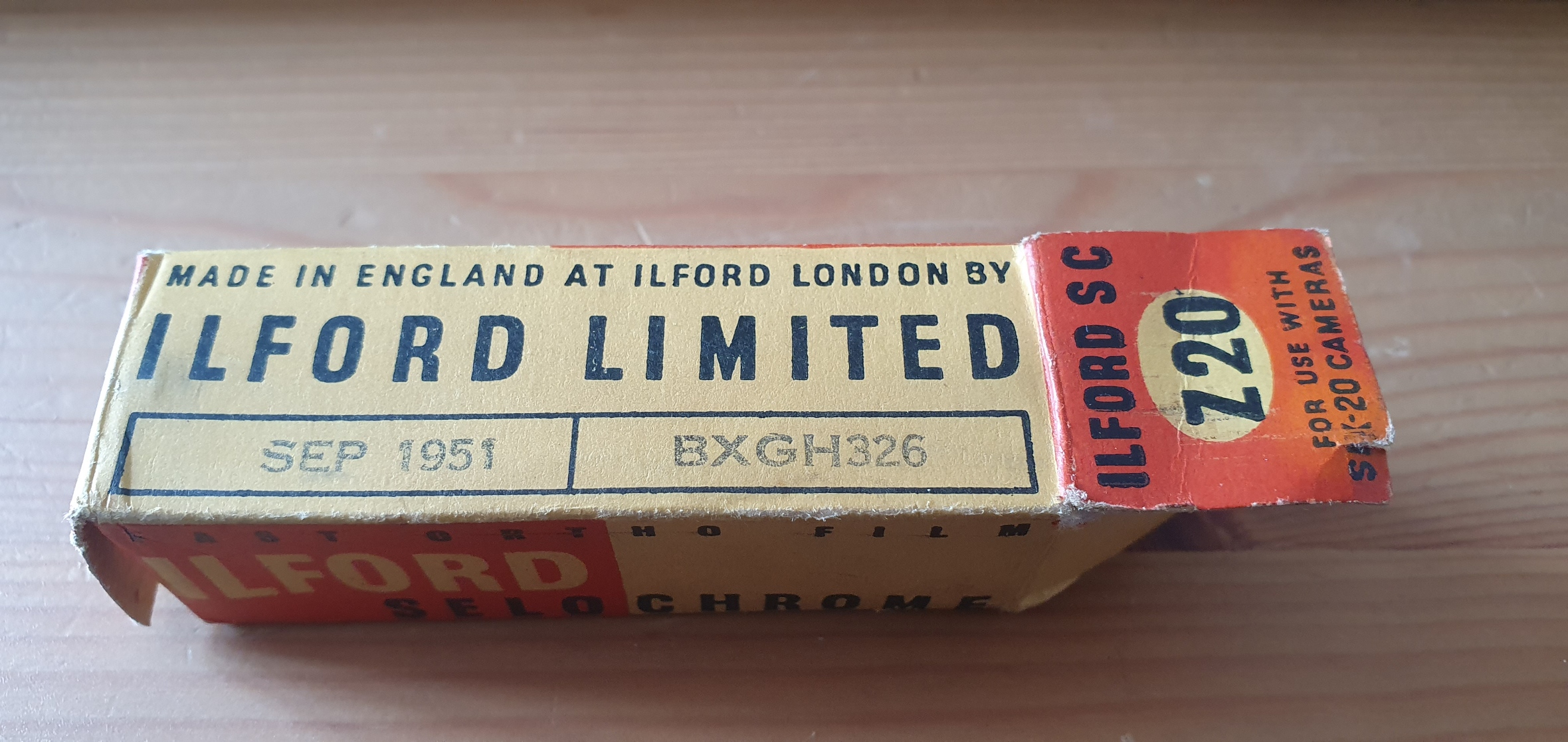

What was the Z 20 format? Is it a modified version of 120? That's an interesting piece of photographic history. And was Selochrome color?
I think Z 20 is 120.
And Selochrome was B&W.
It was a 620 film. 120 films/spools are slightly longer and wider than 620 films.
And yes, B&W.
My plan is to bracket the exposures and shoot three frames per shot at ISO1; ISO5 and ISO10. This will give me four shots and hopefully one of the three exposures will give me something to work with. If not then it will have been fun trying. Harman labs will carry out the developing.
I have some ideas of what I want to shoot (as much inherent contrast as possible) so when I can make the plan come to fruition I will share the results with you.
Thanks. In the interest of pedantry and clarity, for those who didn't know, 620 film and 120 film are identical, but the spools they are loaded on differ.
