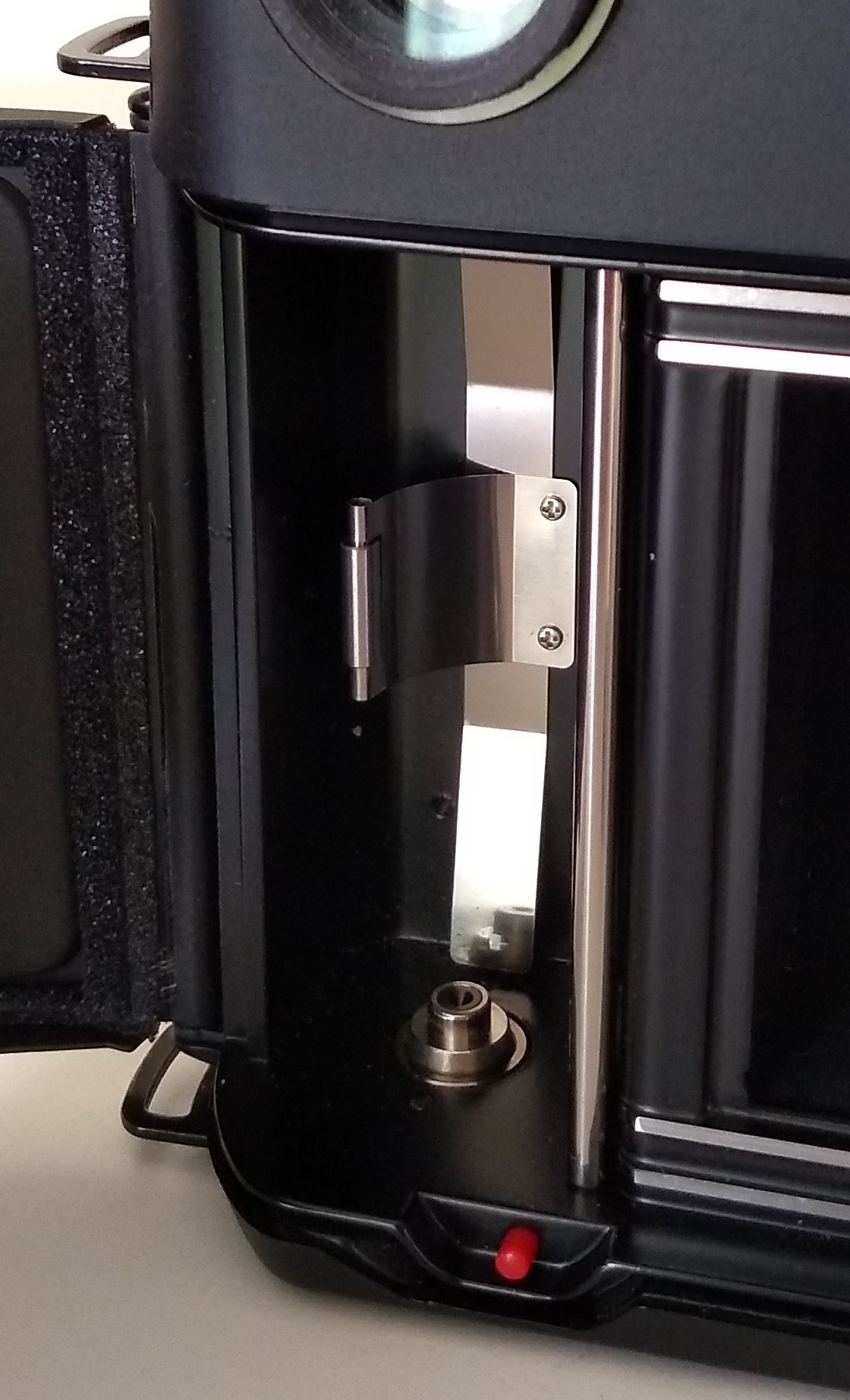

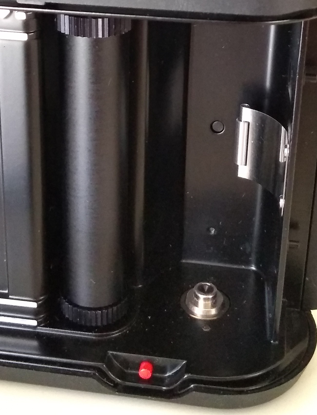

The issue may be the particular flat metal spring (or "brake" as they say in the industry). Some cameras have these where there isnt much force applied to hold the film secure on the roll. Easy to fix by gently bending it.
Good call, I had not thought of that. I will check it, thank you.
(I follow the loading procedure outlined in the manual, and again, this is the only mf camera I have had this issue with)

... I will check it, thank you.
Here are some photos of my springs. If you have to adjust yours, be very careful!
View attachment 224778 View attachment 224777
The only thing that really annoys me about these Fuji rangefinders is the narrow slot one has to reach through to change shutter speed and aperture.
Already gave it a tweak, thanks! Of course now I just noticed that the foam light seal on the door hinge/camera back area has fallen apart. I'll have to put a fresh strip there.
