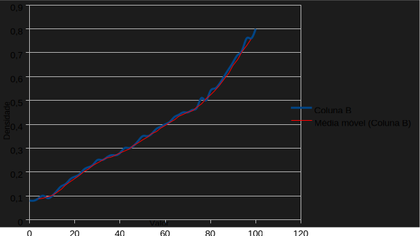

Here are the densitometric readings. They were taken with a very old Heiland densitometer.
Delta D value is 0,72
The last acetate I did on the same printer had a Delta D of 1,44. So althogh it's the same printer, values do change depending on the substrate
I see no values on the vertical axis. It's unclear to me between which points the 'delta' is is taken. I don't know what the blue vs. the red curve are.
I short, I see a shape and it's somewhat non-linear, but that's about all I can red in that chart.
This is certainly true.
