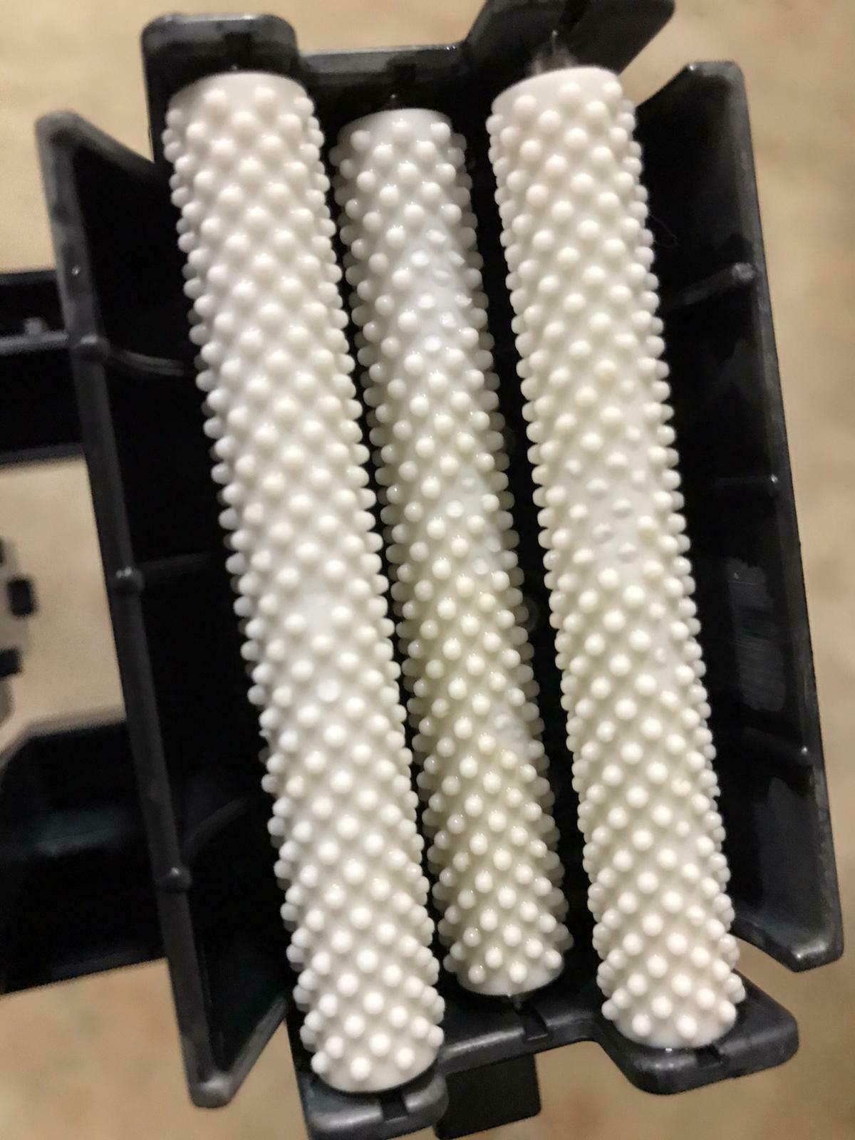

I developed in a Lab-Box and I didn't do any sort of "bath" to sit the box in so the temp on the chemicals most certainly dropped a little bit
Could there have been moisture or residue on the film guide in the lab box?
I have not used one but is there any roller in the unit that comes in contact with the film?
I remember a similar pattern problem years ago with C41 machine processing and it was caused by a Noritsu dimpled roller. (just a thought).
LB has no roller, but a plastic guide that is very easy to keep clean. It couldnt really cause this effect.
I have one, and cant see anything in the LB that could do this.
Its fairly thick plastic and if the LB is not too far from the Dev temp I cant see it causing a radical drop either.
This pattern isn't quite regular. Manufactured items like those Noritsu rollers generally are.
