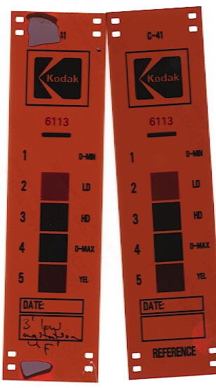

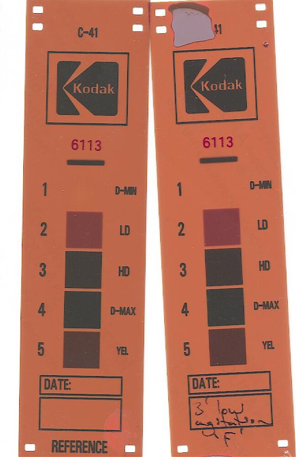

Here's a scan of the latest strip alongside the reference....

I ran the image through some tests in photo shop. It said and my eyes agreed, that the two images differ in that the one on the right has more overall cyan in it, or the one on the left has less cyan. Otherwise, they both seem to have a similar neutral scale.
Therefore, I would suggest trying to make a contact print of these two strips side by side and balance the neutral. I think you will find that they make identical neutrals at the same balance, but differ only in density. The one on the right will be about 0.1 darker in the print.
This is a guess and is provisional on the scanning process not having distorted the balance between the two significantly.

Here's another scan of the same two strips....I left the color balance the same but changed white point and contrast so that it would be a bit more visible...To the naked eye the patches in the control strip look quite a bit more saturated than the control (this is the case w/ all the strips I've run regardless of agitation or time). Also, the film base appears more red in the reference (not the case in the other strips I've run at faster rpm and normal times) BTW, the control strip is from a 3' development at the slowest rpm on the machine.
It seems strange that the film base density on the control developed in the jobo appears significantly less dense than that of the reference.

If density is lower in the dmin, then the process is what we call 'cool' which means underdevelopment, nothing more, but if contrast is high, or density is high, then it is 'hot'. This has elements of both.
I would stick by my suggestion above. Make one print at the same balance from both strips on one sheet of paper. I'll wager that they both look good except the test strip will be just a tad darker than the control.

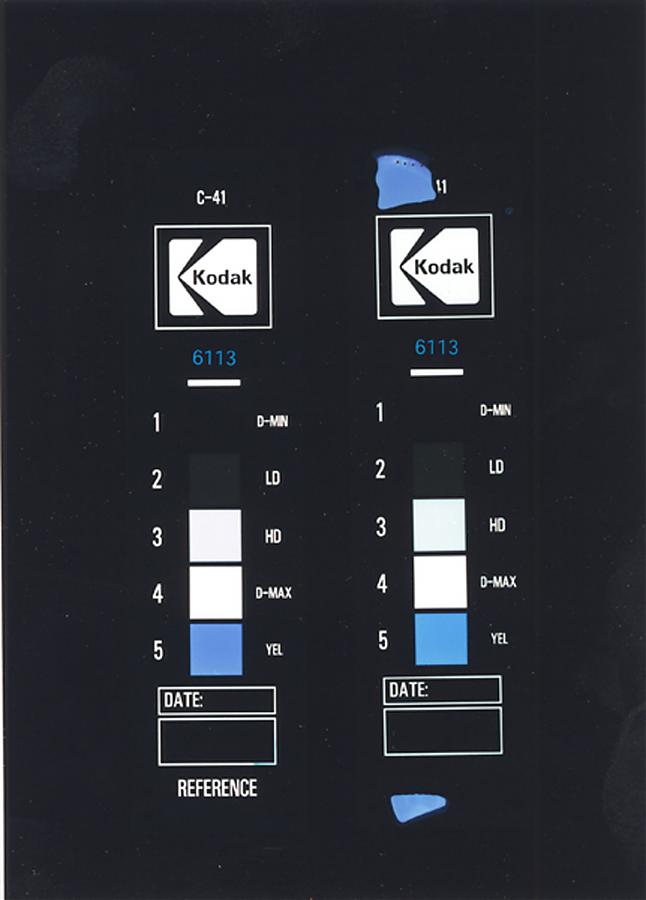

I've attached a side by side contact print of the two strips. As I expected, the control strip has a strong cyan cast especially apparent in the YEL. but also very apparent in the HD. This was printed at 50 points yellow, 40 points magenta.

The scans look as if they differ in speed or density rather than color balance.
I cannot see a color balance difference in the posted pictures on my monitor. And, a C41 color developer (not developer replenisher) should not need starter.
BTW. these two samples are no where near balanced. The spots near the bottom should be both balanced to neutral. I would subtract about 20R for starters. I would also increase the exposure until the middle patch showed some density.

Wait...the spots near the bottom should be neutral? Do you mean that the Yel. patches have too much cyan in the print and so I should add about 20 points red to the print? Other than the yellow patch which I assume should appear blue in the print, I have no idea what I'm aiming for in my print. I guess the dmax should appear paper white, right? And I'm guessing the LD patch should print ever so slightly lighter than dmin and thus determine my overall exposure. Please advise.

The Kodak control strip is a neutrally balanced step. Your samples are both slightly overexposed and too cyan. You should see a white spot and grey spot and black spot. Not several white and one cyan.
The bottom spot is labeled "Y". So this should be pure blue, not cyan. I may have over estimated the amount of 'red' to change the pack by, but that might be due to the slight overexposure.
I think that the point is that both of these printed nearly identical, and not far out as your measurment indicated. Reprint with less exposure to lighten slighlty and reevaluate the bottom spot for being blue or cyan. That is what I'm trying to say.

My advice above contains a typo. I meant UNDEREXPOSED.
The neutrals should display one BLACK step, one GREY step, one light GRAY step and one CLEAR step. The patch should be pure BLUE with no hint of a cyanish tint to it.
Yours appears to have two white or clear steps.
