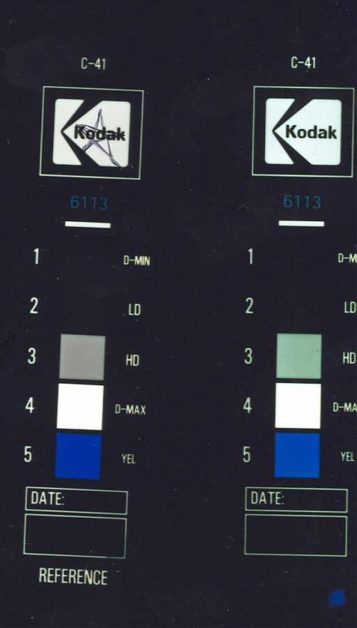

...Phew!...I finally got back to making a decent print of the control strip next to the reference. Look what happens to the control hd when I print for a neutral gray in the reference hd! Out of control man (nice color green though)! I'll show you a c.c.'ed print of the 2nd sheet of 4x5 that I developed at the same time as this strip in a sec....

I laid a 40 magenta filter over the right hand step wedge. It then appeared to match the one on the right. Even the blue patch was corrected. This could mean only a color shift, not a contrast change.
It suggests that there is a color shift only, but I cannot prove it. You are seemingly doing everything right, but getting a cyan shift. That suggests underdevelopment somehow.
In any event, try taking some pictures of a step scale, as I suggested, and then printing it. If the scale goes from magenta through neutral to green, you have crossover. But, if you can balance it and get true color, then the situation is ok as far as I can tell.
