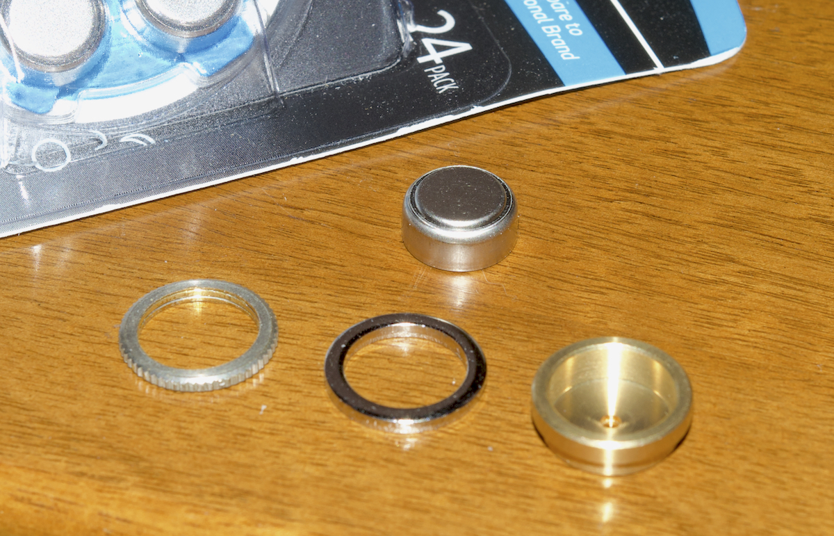

I have used a number of things to adapt the zinc batteries. The right shows a retaining nut from a panel mount toggle switch that fits perfectly. Next is the washer from a Wien cell and to the left is a brass machined adapter from the internet. I just got the brass adapters and I think they are the most convenient solution. I got two to try them but would like a few more.

The brass adapters I have were ones that I purchased through Jon Goodman, of light seal fame. They work great, and were at the time very reasonable. And as mentioned, unlike o-rings, they work with cameras or meters that have terminals on the side.

Judging by the price of the brass adapters at only around $5/pc, that seems the best solution and they make more sense than buying $5 Weincells to take the rings off of. Glad to know they work.

I put a slot in the side of one of the adapters I crafted to make extracting the battery easier. I used a dental pick since that's what I had handy.
Maybe a slot could be made in the brass adapter for that purpose?
EDIT: I see a hole in the bottom of the adapter for the purpose of pushing the battery out. Didn't notice that before.
