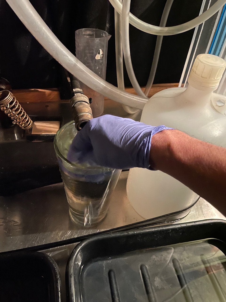

I develop my prints for three minutes in Dektol 1:2. I’m using those blue gloves.
I do this to avoid future contact dermatitis.

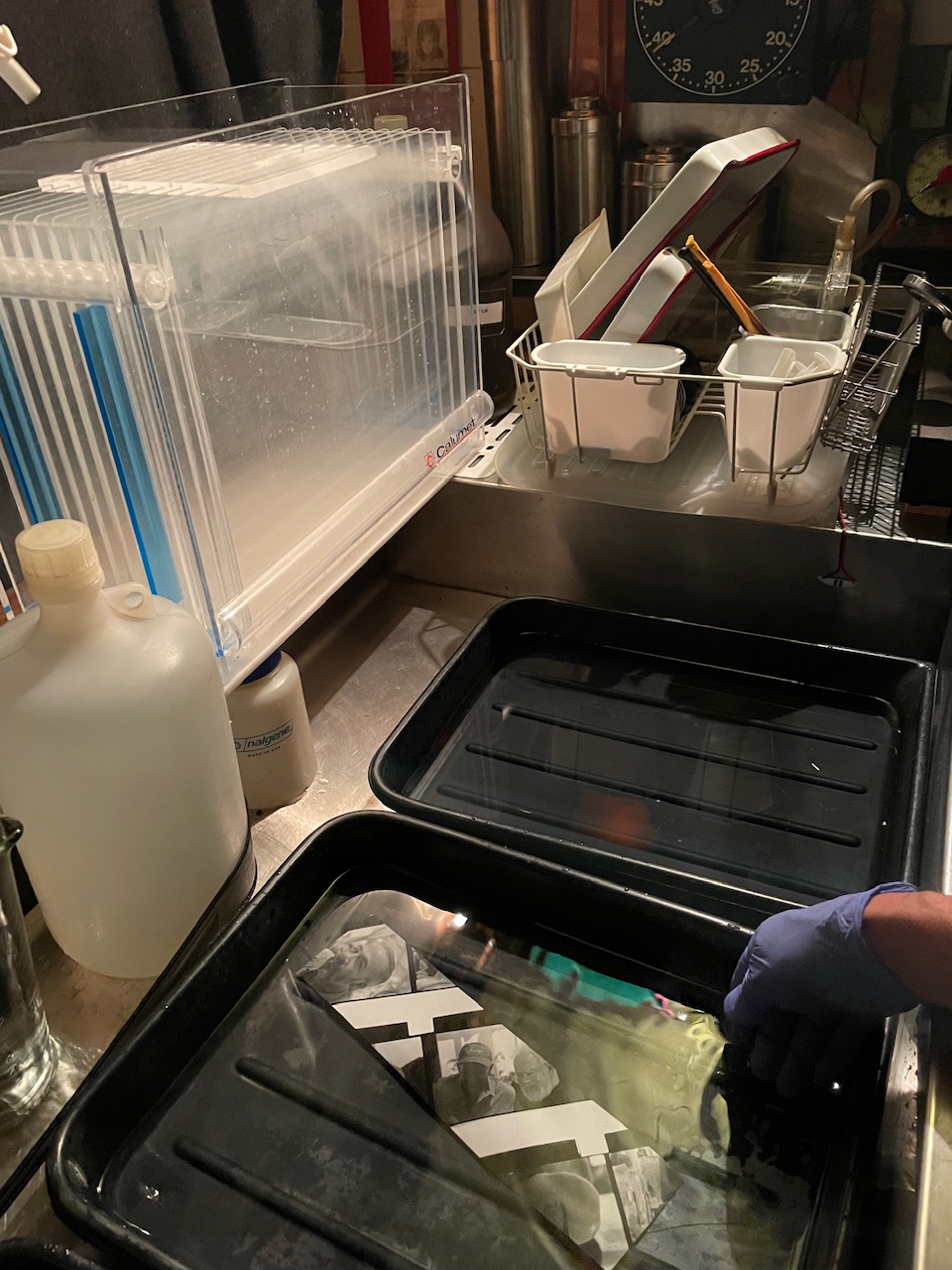

I went through five gloves yesterday in 9 prints and a test strip. Did the test strip one-gloved. Did the prints in two batches of four, double gloved, followed up with a straggler.
