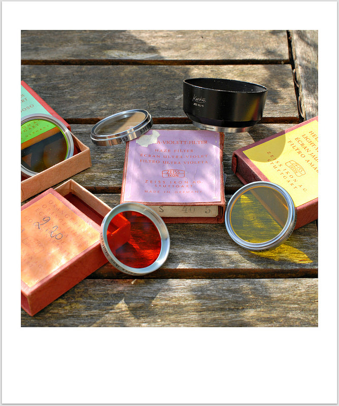

A quick shot of my Zeiss Ikont AG Stuttgart filters -
from left to right : Yellow-Green, Orange, UV and Light Yellow filters. In the back a Kenko 32mm slip-in hood that fits the filters.
Please notice: The box that came with the UV filter is from a S40.5 Zeiss Ikon filter - I'm still looking for the original box.
Luxury problems ...
