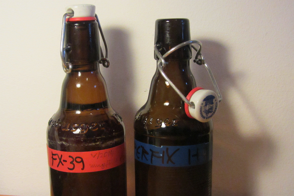

Ordinary pressure-sensitive vinyl electrical tape, white, written using a black Sharpie.
Easily visible. Never smears. Never deteriorates. Stays attached even in hot water. Peels off clean. Cheap. Readily available. Offered in other non-white colors if desired.

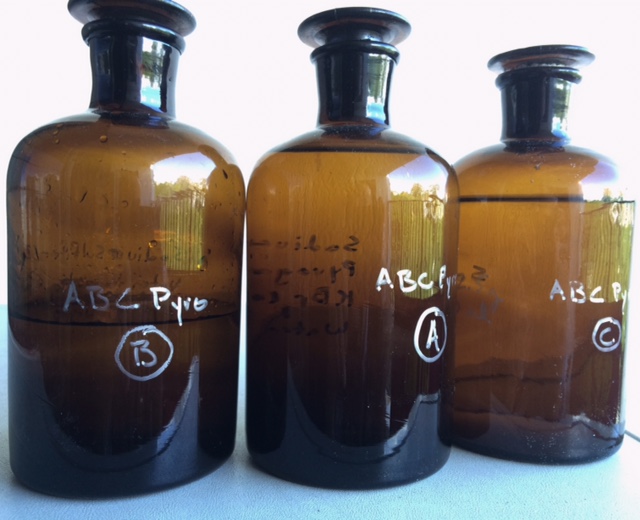

I write on my brown glass bottles with silver Sharpie.
David, do you have any issues with that wearing or flaking off?
cowanw, same question.
Wears a bit over time, but holds up pretty well.

The silver ink looks great.

I print paper labels, then use clear, 2" wide packing tape to cover. Labels are 1" . That leaves 1/2" top & bottom for overlap to seal the paper. Rarely do I have to replace the label. Use it on brown glass bottles and both brown & clear plastic bottles. Cheap and effective.
