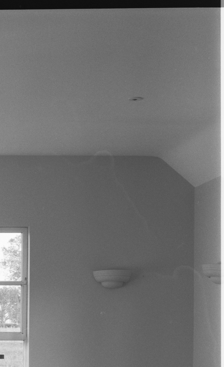

I've recently been battling a water spot problem as shown in the attached. I thought I got rid of this about two years back with a filter on my tap.
Of note:
- This is 120 HP5. Image attached is top right of frame 10 (6x6). Usually happens on one or more of last 3-4 frames.
- Up until the issue has appeared again, I have always used tap water for every step of the process. Upon seeing the water marks reappear a couple weeks ago, I decided to change to bottled deionised water just for an extra two Ilford washes (which includes 3 min soaks), then also for the wetting agent mix (1:200 or 5ml to 1l) which I leave the film to soak for another 2 mins.
- I have tried more and less wetting agent with no change, all else equal.
- Wetting agent is Ilfotol, brand new as are all chems.
- I use a Patterson tank and do everything in the tank until taking the reel out and putting it in a jug with the wetting solution.
- I then simply take the film off the reel and hang to dry, always ensuring there is an unbroken sheet of water on both sides of film. No squegee, no fingers.
- I dry in a bathroom after running shower. Usually have the radiator on and it's about 25-30C in there. Have tried with and without radiator though, down to about 10C ambient temp on this last roll.
Are water spots like these always from the crap in the water, or could it be from elsewhere? Interestingly, I can't actually see the marks on the surface of the film, neither emulsion or non-emulsion. So I was wondering if this could be happening during development and it's actually in the emulsion? Using deionised or distilled water for the whole process feels a step too far for me as I worry about the storage and recycling of all those 5L bottles. But if anyone really thinks it could be happening during dev I could give it a go for sanity. Conversely, as I am using deionised water now for the most critical stage for water spots with no change, seems like I could just as well go back to tap water.

Just to verify: are the drop patterns indeed consistent with the orientation of the film as it was drying? Droplets pointing downward?
I'm puzzled, frankly, since the combination of deionized water and a gelatin backing layer on 120 film should protect you from these marks pretty effectively.
Do you only scan or also wet print? Is there a possibility of contact printing some negatives to verify the spots are really there? Really, if an imaging system picks them up, they should be visible to the naked eye as well, at least with a little effort.
Yes, that's conceivable. Visual inspection would help here. If it's a development artefact, these marks will consist of silver density; i.e. they will look dark to the naked eye. If they're water spots, they're generally calcium deposits, will have a light color.
I scan and wet print. Just to be clear, I can see the marks "in" the negs when inspecting on the light box and indeed they are dark, but I cannot see deposits as such on the surface of the film.
And yes, the spots appear to follow the orientation of the film when drying and being only on the end frames, this is why I am uncertain about it happening during dev.
Sure look like water spots to me. However, as Koraks says - you should be able to see something with the naked eye. They don't look like a developing artifact, not one that I have ever seen.

What do they look like? Is there a possibility of photographing them? I know this will probably be challenging, but it might help.

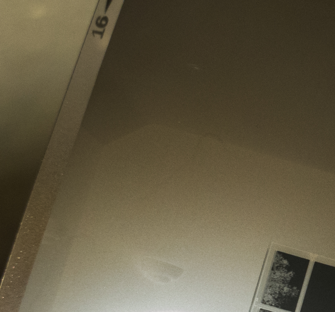

Sorry, I edited my post after you replied to say they are dark which indeed may be instructive. See attached

Hmm, any change of making the marks visible with reflected light instead of transmissive? Transmissive it's always going to look dense. Might be even more challenging to picture it this way, sorry...

As I say, this is what I am struggling with. I am unable to see it when reflecting the light off either surface of the film. It does appear like it's just in the developed image in this respect.
I get it; yeah, that's odd.
I can only imagine these to be some kind of water spots, and they'd be hard to spot (heh) in reflected light because the gelatin emulsion (on both sides of the film!) is similarly lightly colored. So it's probably only possible to really see this when looking through the film and then it'll be difficult to differentiate between silver density or other forms of density.
I don't really see how this could be development-related given the direction of the droplets, which doesn't seem to be consistent with any development process except maybe dip & dunk, which evidently you're not doing at home.
This is a bit of a stretch, but do you also get this when you use fresh fixer (assuming you reuse fixer a couple of times before discarding it)?
Yeah it's fresh fixer. Something I have just considered is that I have a bit of an OCD habit atm of once I've poured out the fixer, then poured in the first wash water, before I start the wash I take the reel out of the tank briefly to check it has fully fixed, put it back in, then begin wash. Possible culprit?

These look like differential drying marks to me. Since everything you describe seems in order, there are only a couple of things I could suggest you try.
1. increase your soak time in the distilled water/wetting agent mix to five minutes. That helped me when I had really hard water.
2. Reduce the amount of wetting agent you are using to the minimum needed to cause complete sheeting action (no droplets or empty spots).
3. Squeegee gently between index and middle finger to remove excess liquid.
4. Hang your film at a slight angle to dry.
If that doesn't do the trick, the next place to look is development or pre-development.
Hope that helps,
Doremus

Thanks all. Differential marks make the most sense to me from the suggestions and looking at the pattern.
As such, I am going to keep all else equal and fashion a way to hang the film at an angle. I've not shot quite as much, but I have never had an issue with these marks on sheet film (which I hang at about 45 degrees) and given the problem never impacts the first 8 frames of my rolls, it follows that the length of water runoff vs sheet film is evidently a pretty big factor in the equation. I feel quite confident that this has to show at least some improvement.
I will first give this ago before resorting to fingers/wipes of excess water.
