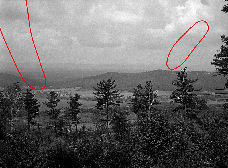

Ok, here is the photo I used in my original thread. This shows the result of too much photo flo.

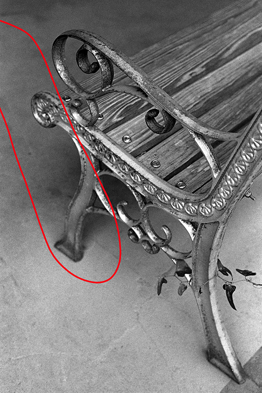

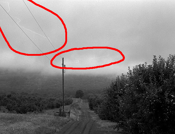

I have two examples of differential drying marks. Both of these results happened when I was using distilled water only for final rinse. The effects are very hard to see. I've darkened these exmaples down to make it more visible. Basically a higher density area that shows as a lighter area along where a line of water would sit while the film around it dried.

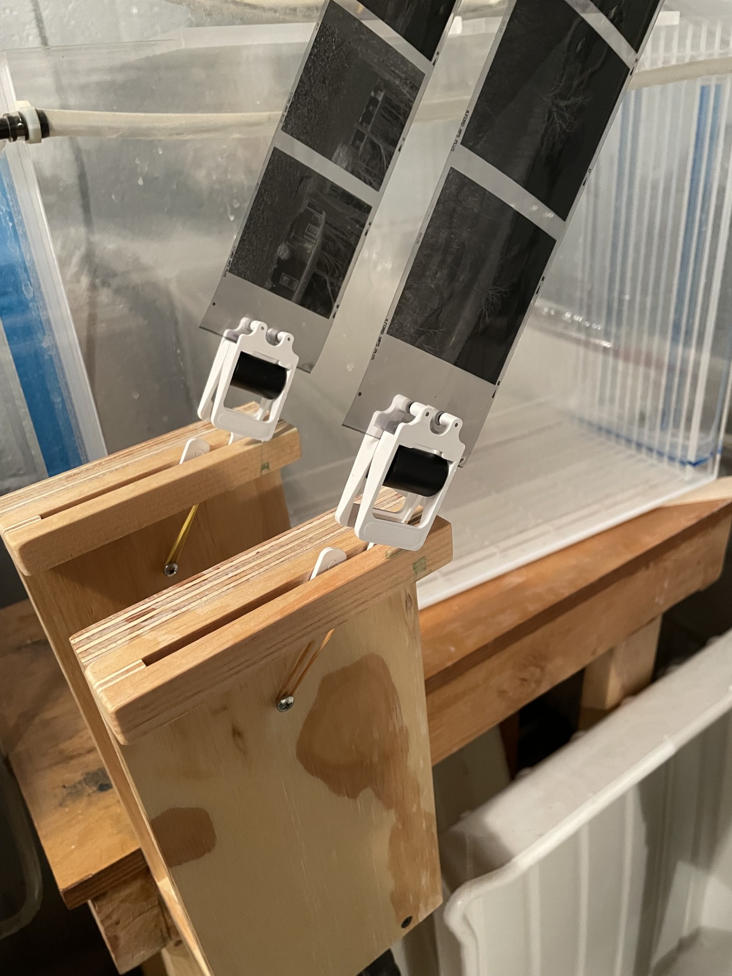

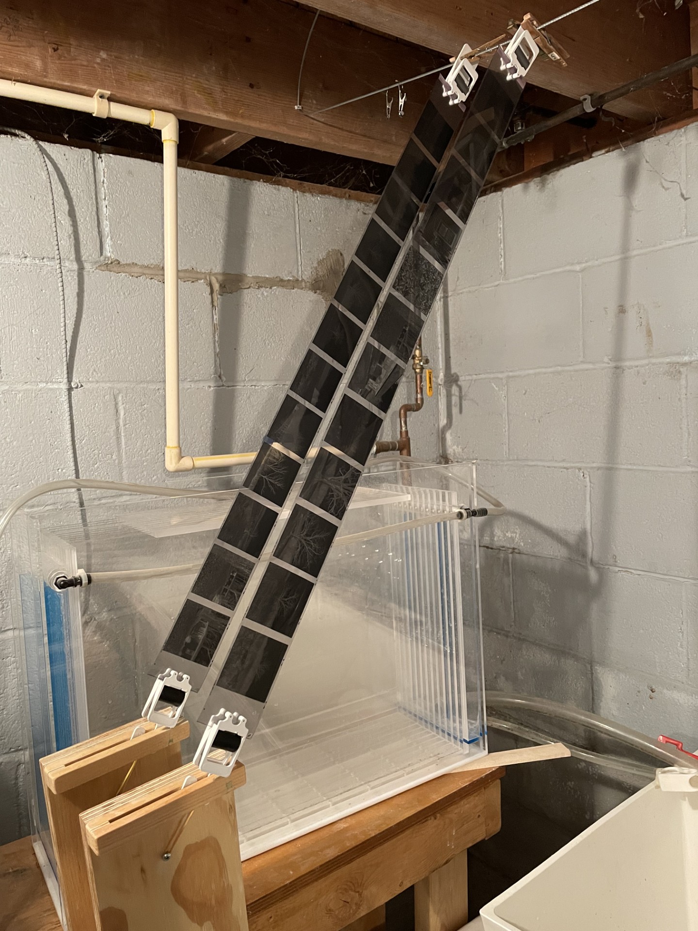

And here are two pictures of how I hang my film at an angle. This is 120 obviously, with 35mm I put the wood block onto the floor and get it at as much of angle as I can. I'm in the process of trying to fabricate something to hold 35mm at a stronger angle.
I should note that for me I use 5 drops of photo flo in 500ml of water for 120 film. For 35mm I kept getting marks with only 5 drops so did some testing and found that I need 20 drops in 500ml of water for 35mm to flow off nicely.
Since I’ve gone over to this method I never see any type of marks anymore.
