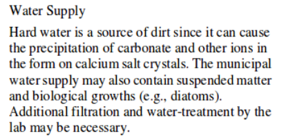

georgegrosu
Oct 15, 2007
434
Bucharest, R
Sirius Glass "I have very hard water and I do nothing. If there is a problem then do something about it. Do not go looking for problems with water when there are so many other places to have problems."
+ 1
Kodak recommends the following in connection with water used in film processing:
"Water Supply
Hard water is a source of dirt since it can cause
the precipitation of carbonate and other ions in
the form on calcium salt crystals. The municipal
water supply may also contain suspended matter
and biological growths (e.g., diatoms).
Additional filtration and water-treatment by the
lab may be necessary."
https://www.kodak.com/uploadedfiles...t_en_motion_support_processing_h242_h2402.pdf
Processing KODAK Motion Picture Films, Module 2 pag.2-39
