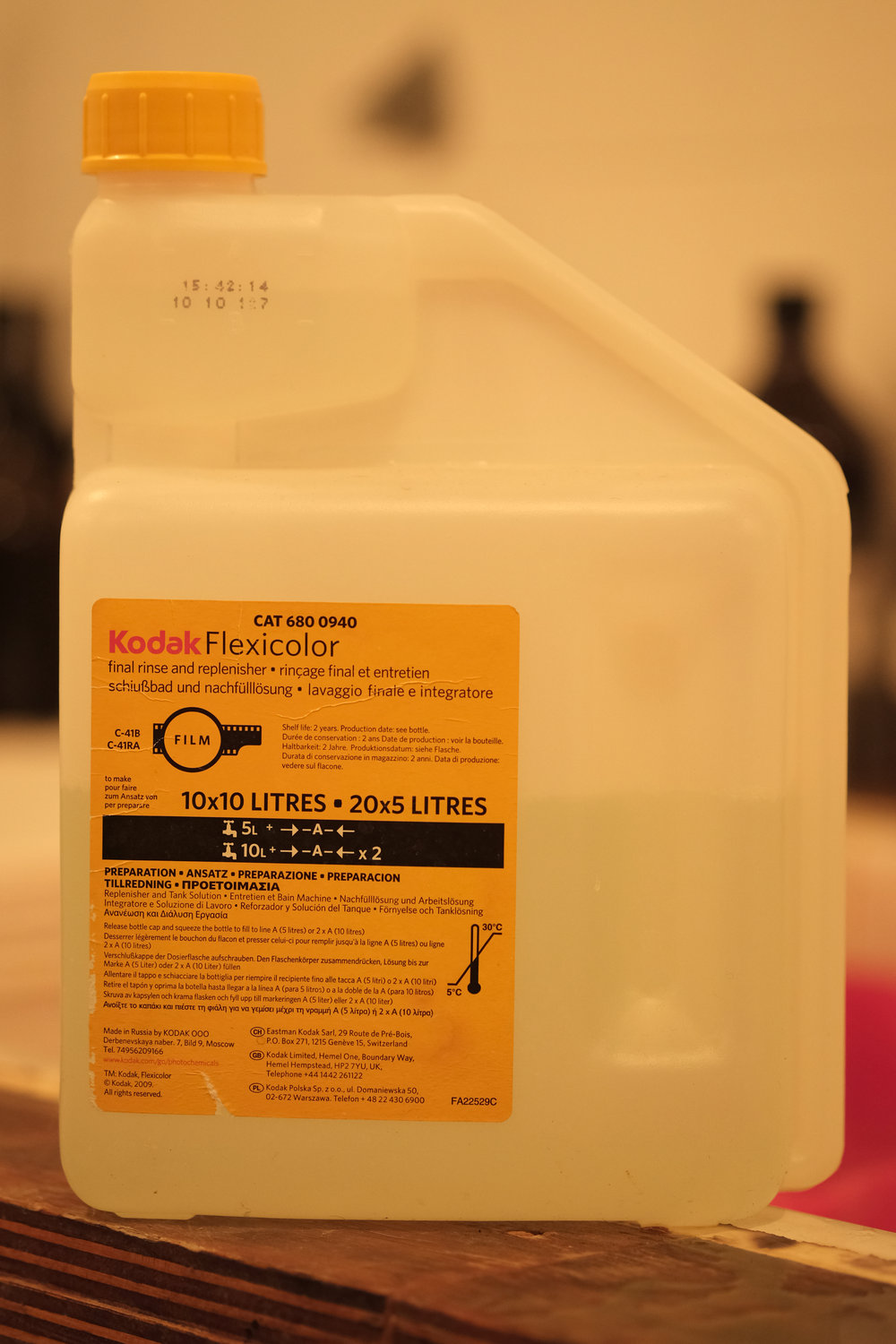

this is the final rinse I'm using:
Tom Kershaw
Jun 5, 2004
4,975
Norfolk, United Kingdom
My process (Jobo CPP-3):
  • Pre-soak 1 minute tempered water (filtered tap)
  • 3min 15secs Kodak Flexicolor - mixed up with filtered tap water
  • 6 minute bleach
  • 1 minute wash
  • 6 minute fix - - mixed up with filtered tap water
  • 4 minutes wash - within Jobo process
  • final rinse (a few ml mixed up in distilled water)
  • hang to dry in cabinet

This is from the MSDS for Flexicolor Final Rinse
3. Composition/information on ingredients Weight % Components - (CAS-No.)
  • 15 - 20 Diethylene glycol (111-46-6)
  • 1 - 5 Mixture of C12-15 alcohol ethoxylates (68131-39-5)
  • 0.1 - 0.6 Isothiazolone derivatives (proprietary)
Can any of the chemists here advise on whether there are any anti-bacterial components in this?

Someone said something about adding some photo flo to the stabilizer. What do you know on this? Will that cause any negative chemical reactions over the years etc.?
Adding photoflo to the stabilizer will not cause problems in the future. It may or may not help you to avoid drying marks. If the stabilizer you are using has a surfactant in it already, it may worsen the water marks. Too much surfactant is as bad or worse than not enough.
To be honest, I have read about many methods how to avoid drying marks, I may even be guilty of having advertised some of them myself, but the whole thing remains an unsolved puzzle for me.
I agree with you totally. I will look forward to reading about what you learn in the fall!
I will say that I always have had drying marks when using the hexamine stabilizer provided in C-41 powder kits, no matter what I've tried. The marks are on the base side only and can show up in wet printing and scanning. My best success in alleviating water marks in colour (both C41 and E6) processing has been to wash thoroughly, rinse with a small amount of distilled water and finally soak in PE's suggested formalin stabilizer. When hanging to dry I run my gloved fingers down the film to remove excess stabilizer. Even with extensive washing (e.g. 30 mins with 30 changes of water and constant inversions), the stabilizer turns pink. I don't know for sure, but I suspect that it is not necessarily problematic, it's just that some of the dyes just take a long time to wash out. I replace the stabilizer every other batch or so to avoid carryover. I still occasionally get water spots, but usually they are minor enough that they would never show up in the print.
For B&W, adding an alcohol to the final rinse can help, but I would avoid it for colour unless you know what you're doing.
The isothiazolone derivatives are biocides, however, just because there are biocides present does not necessarily indicate that the biocides will protect the film. Biocide may be present simply to protect the concentrate solution from going off, rather than providing protection in the film. For example, Rudi spoke with Simon and Ilfotol is not designed to offer bacteriostat protection for film, although it does contain biocides.
I don't have any authority on this, but I would say that since this product is designed as a final rinse for modern C41 films by Kodak, it should function well as such. If you store your negatives at the proper temperature and humidity, I don't think there should be much concern as to bugs eating your film.
