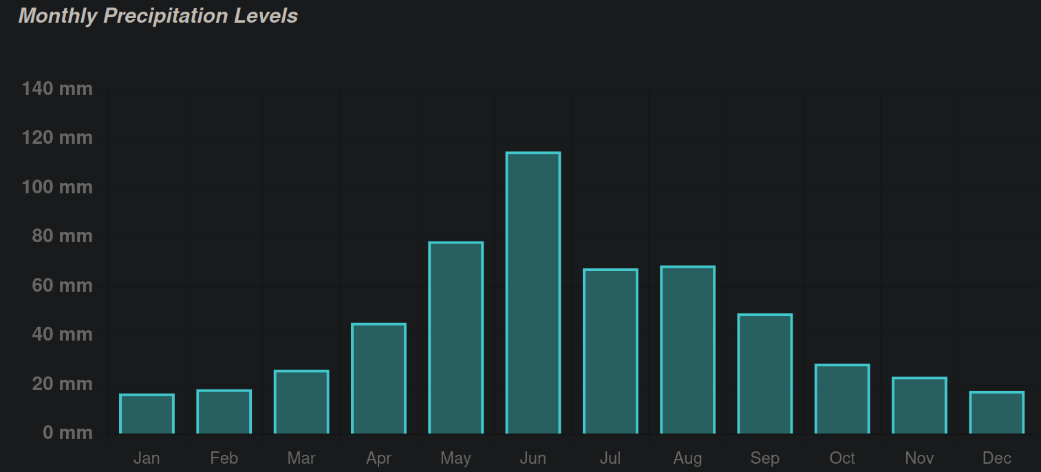

That's an interesting rainfall pattern for Calgary:
Seems to be an inversion of the Mediterranean / Californian pattern.

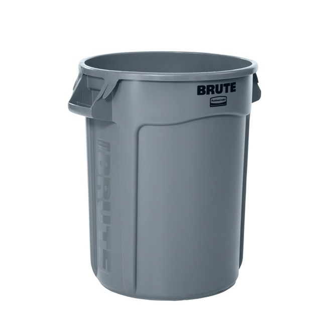

I use a Brute 32-gallon trash can to store water for my garden. I fill it up with the hose a few times per year. It handles outdoor conditions well and was less expensive than alternatives. Don't know if it's safe for drinking water, but I don't use it for that.
I also have three 5-gallon glass carboys I used to use for winemaking. If I ever get around to making a darkroom in my shed I might use those mounted up high along with a vinyl tube siphon.

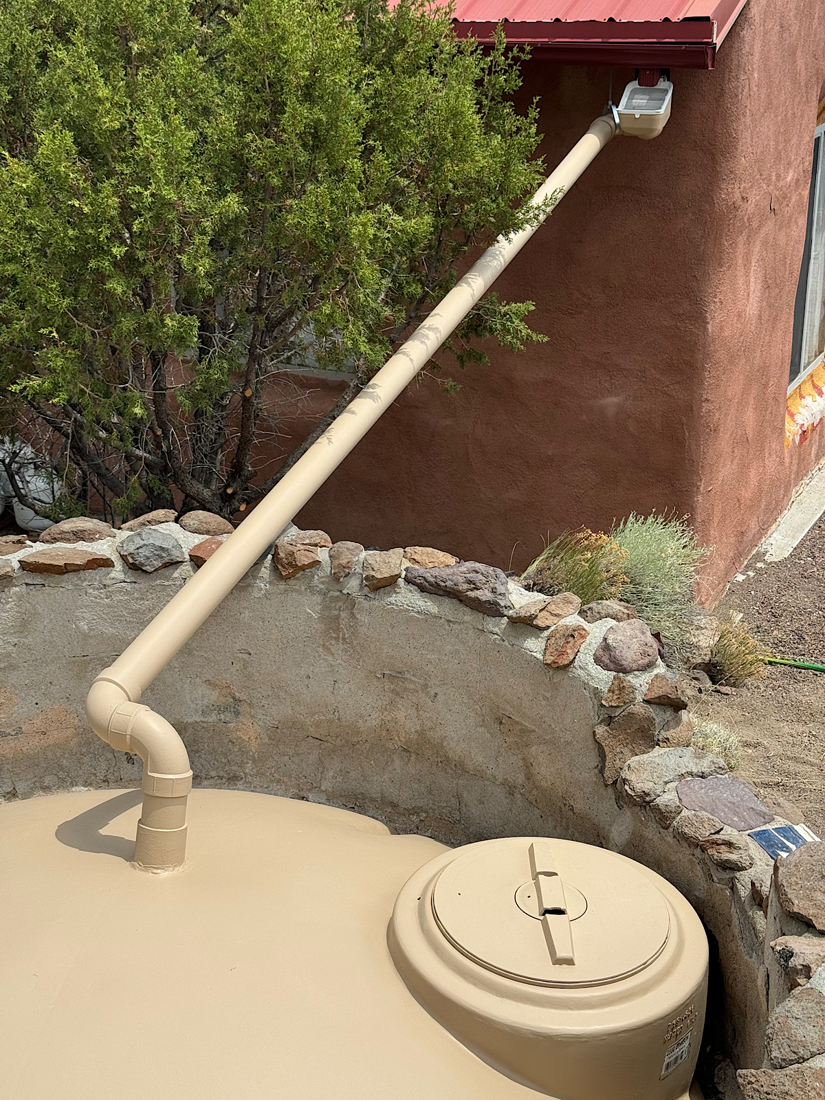

We have a rainwater catchment system for our primary source of water. We use the rain water for everything but cooking and drinking, for which we use reverse osmosis water from our local grocery store. No darkroom yet but that’s in the plans and yes I’ll use rain water complimented with RO and distilled water.
A couple of points, storage is important, you want an opaque tank so that you don’t have algae growth, it also needs to have a good lid to keep rodents out. it should be vented and that needs to be screened to keep mosquitos out. It is also helpful if the cistern is either partially buried or fully underground. That will keep the water from freezing and will keep it cooler in the summer which helps with bacterial growth. We do dose our cistern with chlorine beach to prevent bacterial growth. If it’s not practical to bury the cistern it would certainly be helpful to at least shade it in the summer and let it get sun in the winter.
As far as filtration our system is pretty basic. We have LeafEaters on each of the down spouts and then a good particulate filter right before the pump. We don’t a “first flush filter“ which diverts the initial water from the roof which will have most of the dirt and debris, but it’s certainly a good idea.
There’s a lot of info on rainwater catchment on the internet so if you’re serious, time to start doing your research.
