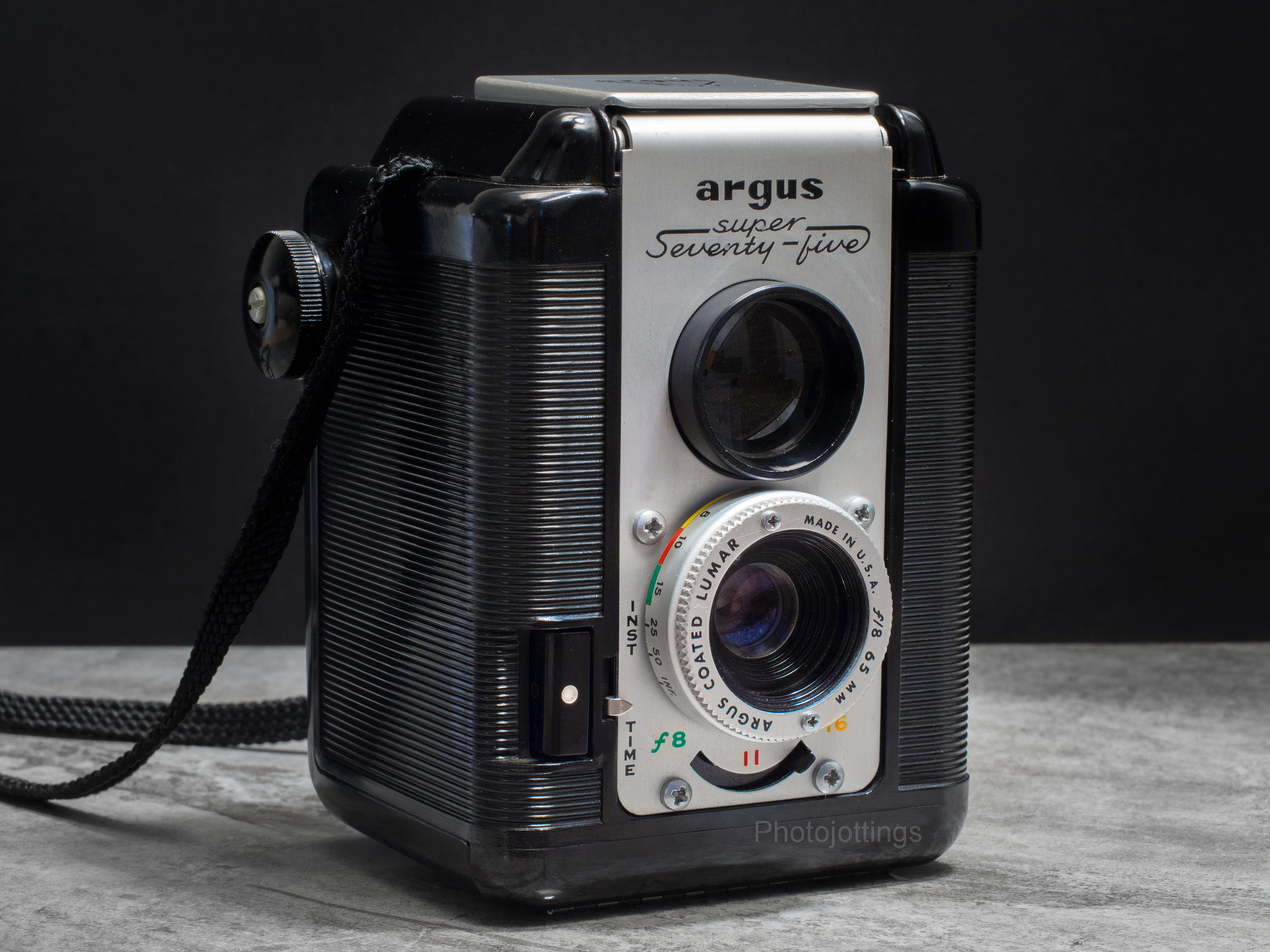

Argus Super Seventy-Five, is a 6x6 camera with semi-wide 65mm Lumar lens. Despite the name, the lens is indeed 65mm focal length.
It is a bit of curve ball, since the Argus is not a folder but a box camera. In addition, it used 620 instead of 120 film. But it is a true semi-wide angle fixed lens medium format camera that is very portable.
I had high hope (Argus 40 was excellent) and tried one, but the optical quality is questionable. It is a bit like glass lens Holga, can be reasonably sharp in the middle but never gets sharp in the edges no matter which aperture setting. Maybe my sample has misaligned lens elements: to reduce costs, the front elements and back elements are mounted separately and there are lots of tolerance play.
Here is a review by someone else:
