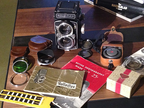

Was out for dinner at a friends last night, they invited us over because they "have something you'll like". When I arrived, they handed me an old
leather case, inside was the ROLLEI, in beautiful shape, along with lens hood, filters, an old GE light meter and other various accoutrement.
Gave it a quick cleaning and reminded myself on its operation...had played with them years ago when working in a camera shop. How cool.

That looks like a 2.8C with the Xenotar. Phenomenal camera. If it is a C, one thing to keep in mind with the shutter is that if you are changing to or from 1/500th, do so without the shutter being cocked (ie don't advance the film before changing the speed). The 1/500th is tough to set because it uses a special powerful spring, and if you change the speed with that spring under tension you can jam up the shutter. Regardless of the apparent condition, I'd send it to a qualified Rollei technician to get it overhauled. But once you do, it will be good to go for another 60 years (with a few more CLAs in the interim). I love my 2.8Es so much I have two, and a Tele-Rollei. I'm seriously thinking of getting rid of the rest of my small format cameras and sticking to just those two for 99% of my shooting.

Wow gang, thanks for the input...I wouldn't say the camera is mint though...but definitely
nice condition. I just ran a roll of film through it, and the counter doesn't seem to work, even
having the film loaded through the rollers as instructed. Lens is a Zenotar 80mm 2.8, no scratches, haze or
fungus on either lens...and the manual says 2.8C. Gents, where can I get it CLA'd? I have very little knowledge on these
TLR's...

Well, a small update...
Shot a quick roll of FP4 through the Rollei, hand metered and when I processed
the film, there is an issue....I see lots of squares, but there is a fog issue, appears
to be a light leak. Looks as though a small screw is missing under where the
camera closure latch is which snugs up the closure. Bottom of the cameras door
seems to perhaps have a slight gap that could be leaking a bit of light in.
Overall exposures seemed pretty good though...focus is sharp.
