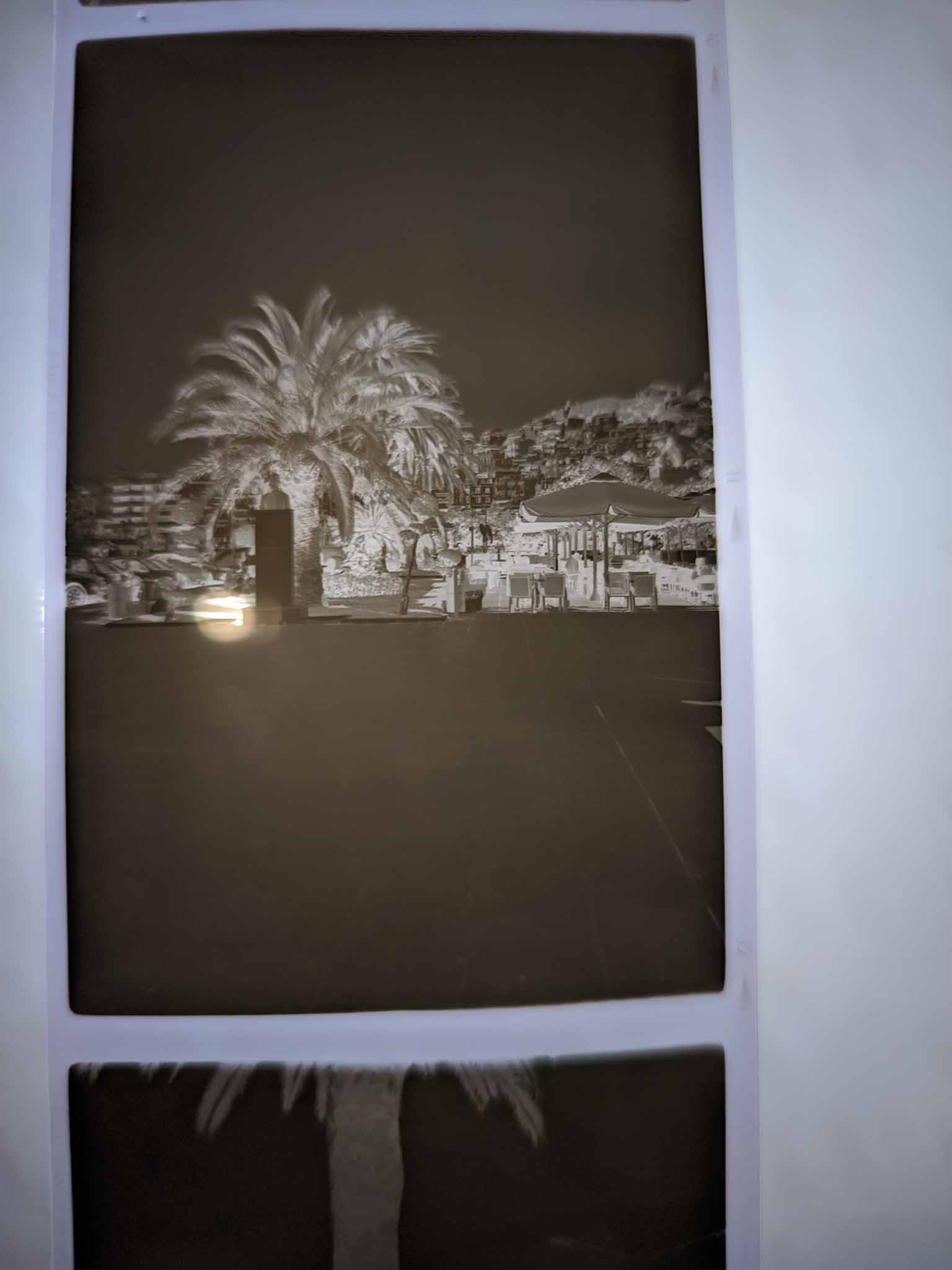

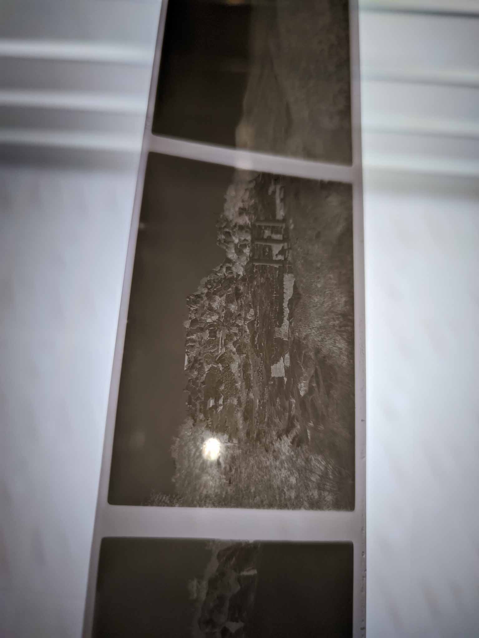

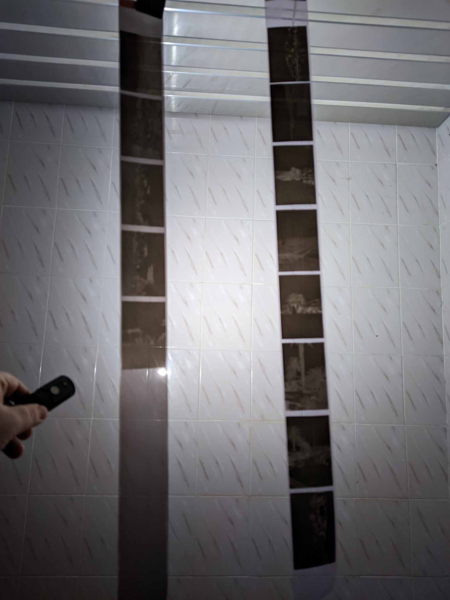

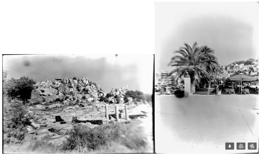

I decided to test a (semi) mount Pyrocat-HD (about 9 months old but looks like new) 1.5:1:200, 55min, 2min initial stir and for 15sec at the 30th min. Initially I was going to put only one OLD film , but then I thought about it and combined two films. One was ORWO NP 20, expired in 1984 (40 years) and stored at room temperature, and the other Ilford PanF, expired at the end of 2022, kept in a refrigerator (practically fresh). Both films were shot at around EI 50 - NP 20 is rated at ISO 80, but is still 40 years old. The camera is from the WWII period, maybe 1938-39, but I'm not really sure.
The films are processed in the JOBO 1520, attached to a single roll. The pre-wash for 3-4 min threw out completely black water. The result - as expected, the NP 20 is quite foggy, but maybe it will be somewhat usable. However, the two negatives became quite thick - more so than I expected. I made a mistake - I was too lazy to control the temperature and it was a little higher - about 22C.
I have two more negatives from the same camera test - Fortepan 100, expired in 1987. If I put some benzotriazole 0.2% (say 0.5 ml per liter) - will it have an effect on the long development times?

Try doing the Fortepan at 1.5:1:250 and only agitating 10seconds at the midpoint.
I dunno if BTZ will help, I've never used it with film in any development scheme. You likely will get less film fog if you semistand develop in D-23 1+3 but it will probably show a bit more grain than Pyrocat-HD.
As best as I can see from your pictures, all those negatives look entirely printable. I've used semistand on film from 1961 and gotten perfectly usable negatives. Bear in mind that - within reason - all fog does is lower overall contrast somewhat. You can fix that with a good does of split VC silver printing, or adjusting curves in a scan.
