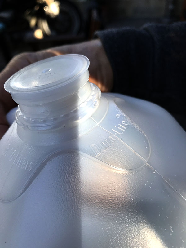

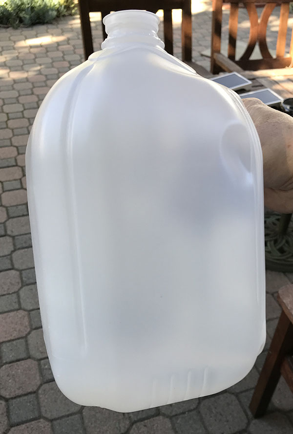

Could someone hint at a photo of such jug likely to crack? I am still clueless.
I mean, schlepping home a jug and then turning out to have already been leaking from within the store seems strange.
There are a number of internet references to the leaking bottles. I believe the leakage occurs because the bottles are designed to be biodegradable.

I'm suspicious of the theory upthread that fragile containers are over concern about the environment or such. I think there's a general trend to design for minimum material in containers just to cut material cost. (I have joked that aluminum soda cans have gotten so thin you can see through them!)
I only use the sleazy water jugs for the water storage. Developers, fixers, and the like I keep in the PET soda or juice bottles; the cheap milk or water containers are known to be oxygen permeable, definitely undesirable for developers.
Lately I've noted a couple of leaky distilled water bottles. I use the distilled water then refill them with tap water in case of need. The ones that have started leaking had been reused a few times already so I just assumed they had been damaged in some way. If they leak I just send them for recycling.
The jugs that my distilled water come in are recyclable so I kind of doubt they are biodegradable, but I could be wrong.

No plastic bottle is pressed.
All plastic bottles are blown out of a tube. Even whole canoes and large tanks are blown.
Alternatively containers are cast in a heated, rotary hollow form. This is done at very complex shapes beyond manufacturing out of a tube, or when same wall thickness at all locations is needed.

Your DI bottles seem to be like the 2L soft drink bottles that came to market in the 90s. Very thin walled, they are pressure filled so that the bottles are ridgid for handling along the distribution chain. Once you open them you have to be careful when holding them with one hand. I don't think they are as popular as they used to be, but then I hardly ever buy such large soft drinks.
The distilled water gallon jugs I get locally are HDPE. Seems durable and I have never had a problem, but this thread has me wary. I store used chemistry in them until it is disposed, usually several months.
