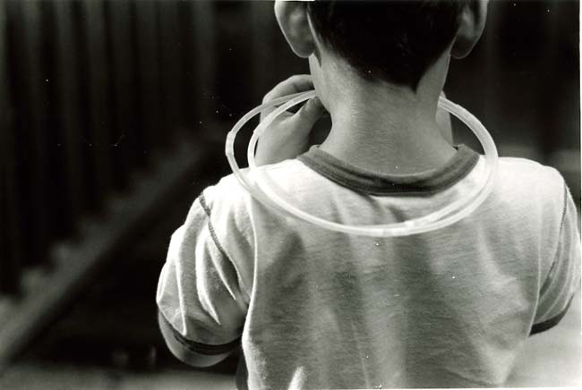

Just thought I'd upload a couple of examples of the Ilford MGIV warm tone. These were developed using dektol, then toned in selenium at about 1+7 dilution. The one with my sons face, still has a slight green color to my eye, but the others don't. I may still try the rest of the pack of paper in a different developer, as the tone isn't quite what I'm looking for.
Someone mentioned that the emulsion can stick to things when wet. Boy, you're not kidding! There are some tiny specs on these scans where the emusion must have stuck to the screens, or perhaps to dust on the screens. The screens will get a thorough washing, and I'll be laying the prints face up on the screens in the future. I plan to try some different papers as well. Will other WT papers have particularly sticky emulsions when wet, or is this unique to the Ilford. I've never had this problem with the regular MGIV.
Lastly, and most importantly, any feedback of the photos would be very appreciated. Just want to get a feel if others think this type of imagery works with the warm tones.
Thanks again for the input everyone!

It does look green, kind of like Forte non-warm tone looks before selenium. My experiences with Ilford Warmtone have been much less green and much more brown. I also developed in Dektol. I don't have anything else to add, unfortunately. :sad:
Good luck.

I dry face down on screens without any damage. I squeegee the prints on both sides before laying them down. These things probably have various causes: local humidity, ambient temperature, etc...
Looking at the photos, the shadows look warm but the selenium does not seem to have expelled the green from the highlights as much, so perhaps a longer or more concentrated mixture? I use 1+4 for up to half an hour at room temperature. Probably a different developer such as Neutol WA will give a better tone.

Nice pictures. However, your chemistry is arguing with the paper.
Dektol is a cold developer, and selenium... well, it might cover a green tone a bit, but adds it's own character. Not to mention adding work to the process.

Using a glycin-metol devleoper, like Ansco 130, will give deep, warm blacks with no green. And you won't need to mess with selenium. You'll get a transition black that is umber, with a little ivory black. The full, paper, black is ivory black. Midtones are shades of cocoa, and the paper white is warmish white lead. Lush, but not arty. You can get a liquid version from Photographer's Formulary, it's called BW 65. You can also get Formulary 130 in powder.
