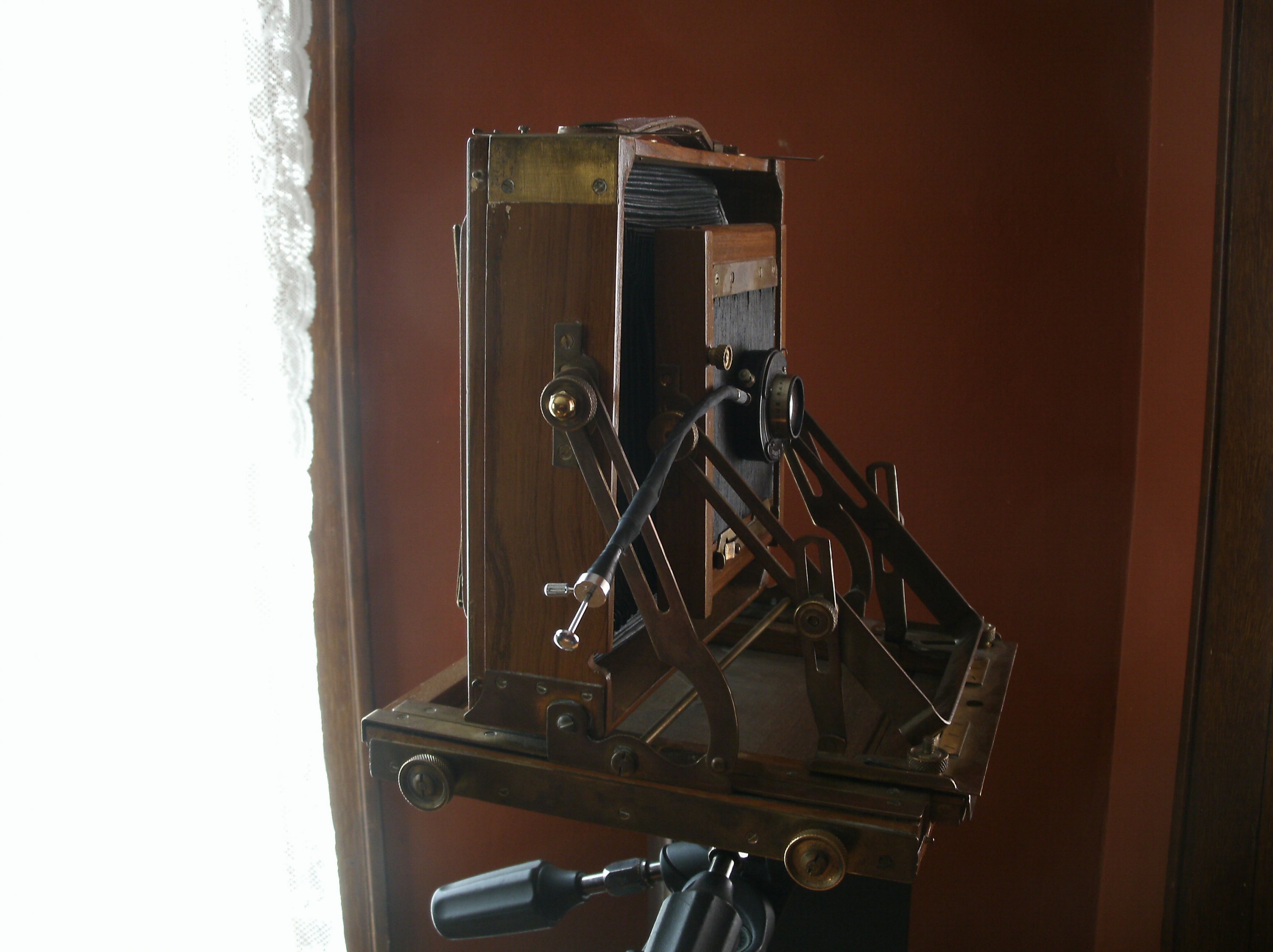

Yes, I have one of those cameras. I like it and it has served quite well but I have always been frustrated by the inability to focus a 90mm lens. Just before focus the front standard bumps into a bracket on the rear standard. I considered a recessed lens board but with the lensboards being roughly 4 inches there is just no room for one and the shutter still be accessible.
Anyone have any thoughts?
Here is the camera with the offending brackets.

I use 90mm and 75mm lenses on my Wista DX all the time on recessed Technika boards. If your lensboard is wood and 4x4 inches (or anything larger and thicker than a Technika-style board), you can easily make an improvised adapter out of mat board or, what I uses, Masonite.
Technika boards are almost 4 inches tall and a little less wide; you only need to make a shim/light-blocking baffle out of something. I have a couple cameras that take 4x4-inch boards (Zone VI and Graphic View II), and I made adapters by peeling a layer of of a pre-cut 4x4 piece of Masonite. I then glued small strips of Masonite (or mat board) onto the edges. This gets sandwiched together with the Technika board when mounting; works great.
When using the 90mm and 75mm on the recessed boards, I have to set the aperture with the end of the cable release or a pencil or something thin. The aperture ring and cocking lever I can access with my fingers.
Maybe my solution will work on your Prinzdorf (looks like a re-badged Tachi to me).

On a Calumet 4x5 I had at one time, I used a recessed lensboard. I found it necessary to attach a 6 inch cable release to the lens before mounting it, and just left it on there all the time. The lens was an Angulon (not Super-Angulon) 90mm, so the shutter release was the only control where access was difficult when mounted on the recessed board.
You might consider acquiring a 90 mm Angulon for just that reason--it's a nice performing little lens.

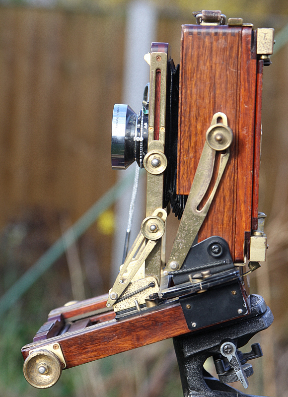

I have a Raja/Deardorff, Rajah body, Dorff backs, 85mm fully compressed as shown. I can just focus a 90mm at infinity without a recessed lensboard.
Obviously I never thought of doing that. What a good Idea.
Hi Mark
I've had a really deep recessed lensboard before, and used a "right angle cable release" adapter. It attaches right to the end of your cable release and works GREAT!
I think it is what Doremus might have been talking about. Kaiser makes one and they are on the amazon thing for about $30..

Part of the issue is recessed lens boars are best made from metal, I have an issue with the Kodak Specialist 2 Half Plate (7x5) camera I bought recently the lens boards are slightly larger than Linhof/Wista but it takes a wooden recessed lens board for it 4¼" (110mm) Dallmeyer WA this is to overcome bellows compression. However the Dallmeyer is a tiny shutter-less lens. The issue is space fitting a modern 90mm WA like an f8 or f5.6 Super Angulon in a recessed wooden board. I'm sure it can be done but the extra wall thickness using wood doesn't help. I've already made an adapter board to use regular Linhof/Wista boards with the camera, I don't have a recess Linhof/Wista board to try but it should work. This would be another option in the OP's case.
