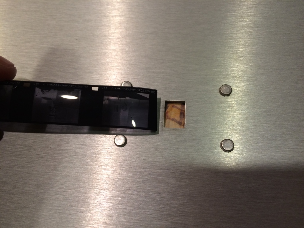

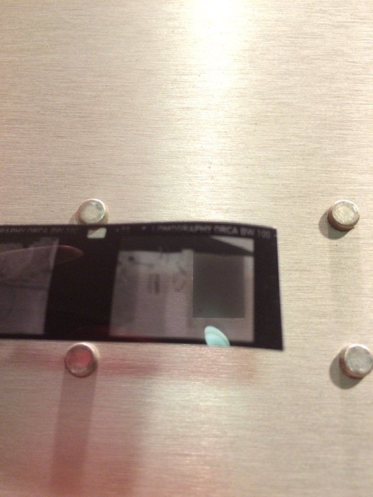

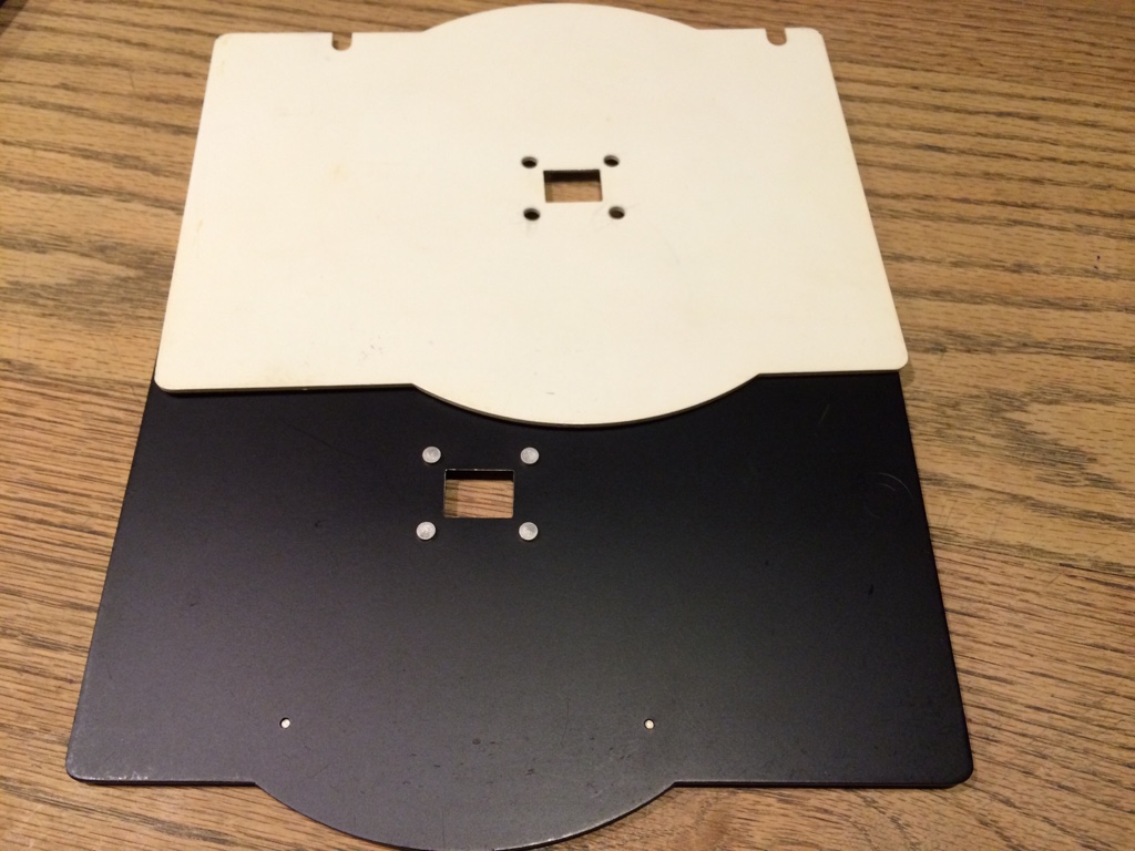

Okay guys I take it back, unfortunately very very kind gentleman who sent me the carrier, has sent the wrong size carrier, I thought this might happen, I received the 16mm movie film frame version of 16 mm, which is much smaller than the 110 which is horizontal. I'll take a picture to show you.
*sigh*
So, Mark Crabtree, if you wouldn't mind seeing if you do in fact have a 110 carrier that would be amazing.
See if it measures 8mm x 10mm, if so, that's a Minox frame. Go get a Minox!
The smaller of the two holes is 8x11 technically, so I guess yes that's minox? Wouldn't it also work for 16mm movie stuck framing?
Haa you are right, the orientation is wrong for Minox, which is what I have...
Must be 16mm movie single.
You could hack at it to make the 110 opening, if the film doesn't sit nicely in the orientation of your photo, you might plan the opening to orient it 90-degrees from "normal" Omega orientation.
Will that fit 35mm film sideways? You might cut a "Half-Frame" carrier from this... and then just use paper masks for 110.
I notice that Lomo exposes a "mask" into the negative. That means you can cut the opening wider than the actual frame, and allow the film mask be the edge of the print. In other words, you can be sloppy with the file... and still get sharp (or slightly soft, but still well-defined) borders on your prints.

Yes j can make masks from paper but then fibers get on the film and this tiny format suffers greatly from fibers/dust particles...
