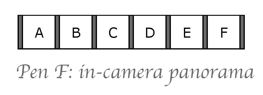

I recently got me a decent Olympus Pen F (with CLA) and was thinking the same: 72 images can take a long time. When I don't have shorter film length, I need a way to properly use the surplus of film (instead of keeping film in camera for a long time). So I came up with this experiment:
I was thinking this this will give me the opportunity to make some nice "multi-exposure-panorama" images as well. The camera is in portrait format when used normally: 24x18 mm size (= half frame). Suppose I want to make a large panorama image from a landscape, using 6 (or so) frames. I aim the camera to the left side of the scene and make a mental mark of the right side in the view finder: let's say a bended tree is just inside the frame. I make a shot, wind and move the camera to the right so that the bended tree is now just outside the frame on the left. I make another shot, wind and move the camera to the right, etc. I repeat this six times, until I have shot the whole scene.
With 6 shots I now have a negative of panorama size 24 x (6x18) = 24 x 108 mm. Plus some mm between the single negatives will give me a total printable negative of (about) 24 x 120 mm with an aspect ratio of 1:5. I'm going to print this series of negatives as one print, without sprockets but with the space between the frames, thus making a nice panorama print size like 8x20 inch or so.
The print will look like this:
attachment.php
Since my first film is still in the camera, I can't show you the results yet. But I saw an example from the previous owner and I liked it a lot.
BTW1: when shooting a landscape this way, I don't turn around on the spot where I stand (making a circle), but I actually walk to the right (in a straight line) if possible (beware of traffic when moving to the right while looking through the view finder!!!)

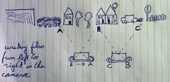

BTW2: since the camera transports the film from left to right and the lens will invert the image on the negative, you must aim & move the camera from left to right to get the images in the right sequence. hopefully this drawing explains that:
