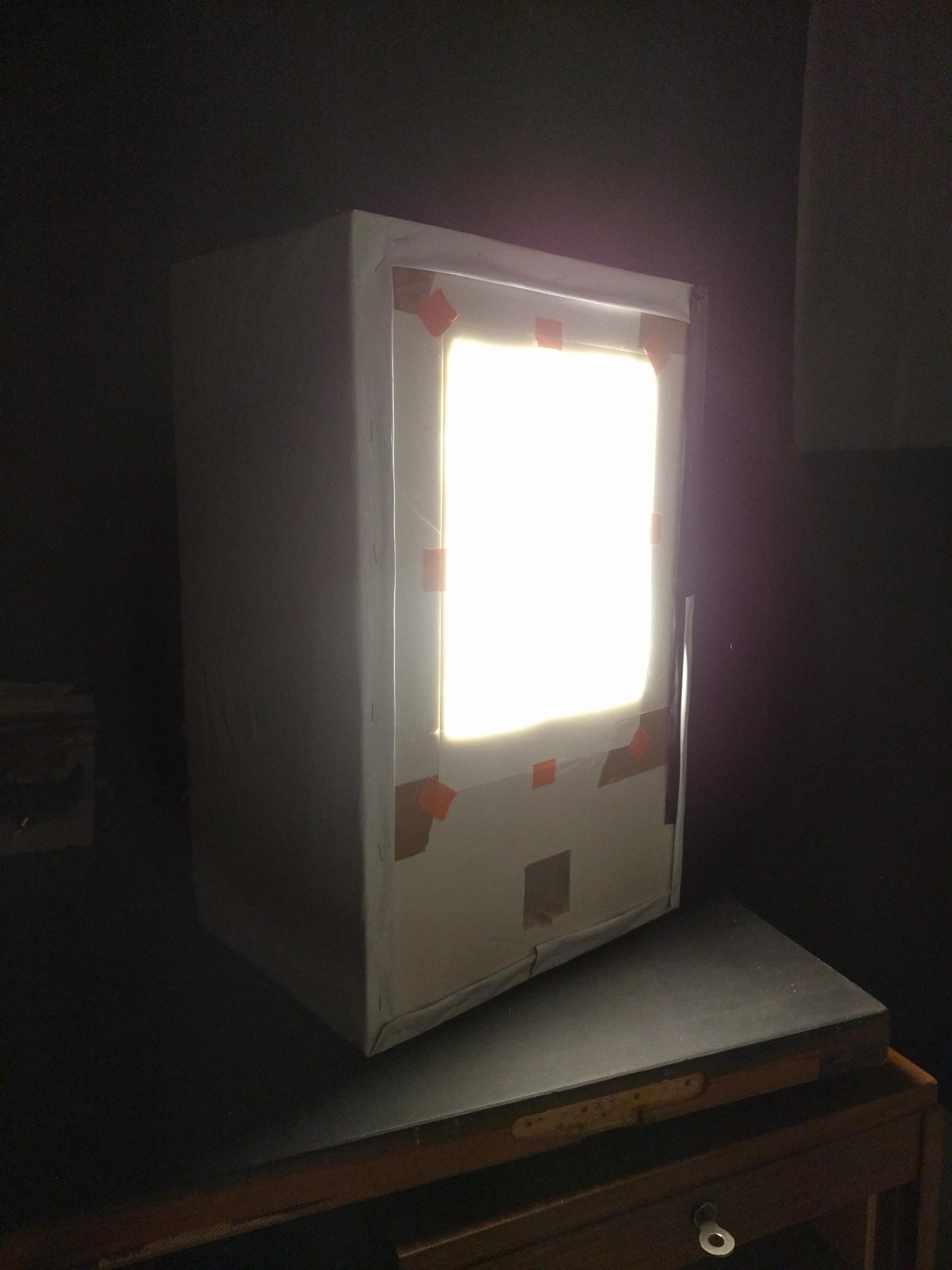

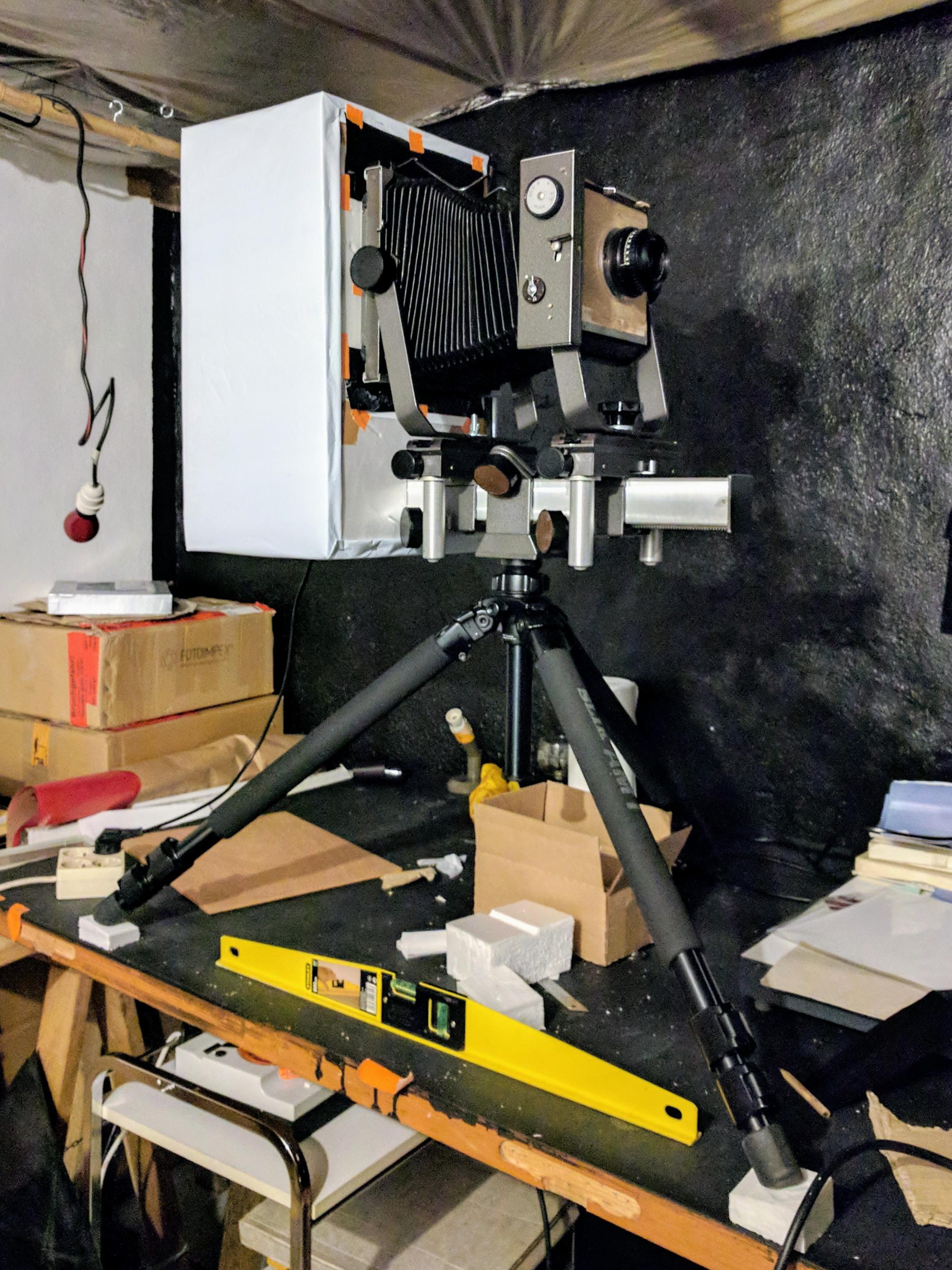

hello op.
it can be done, no problem,but what you will really find helpful is an alignment tool. since i use it my prints are sharp corner to corner, even going big.
it sure can be achieved without, but alignment its so much easier since i have it.
no limits.
pix

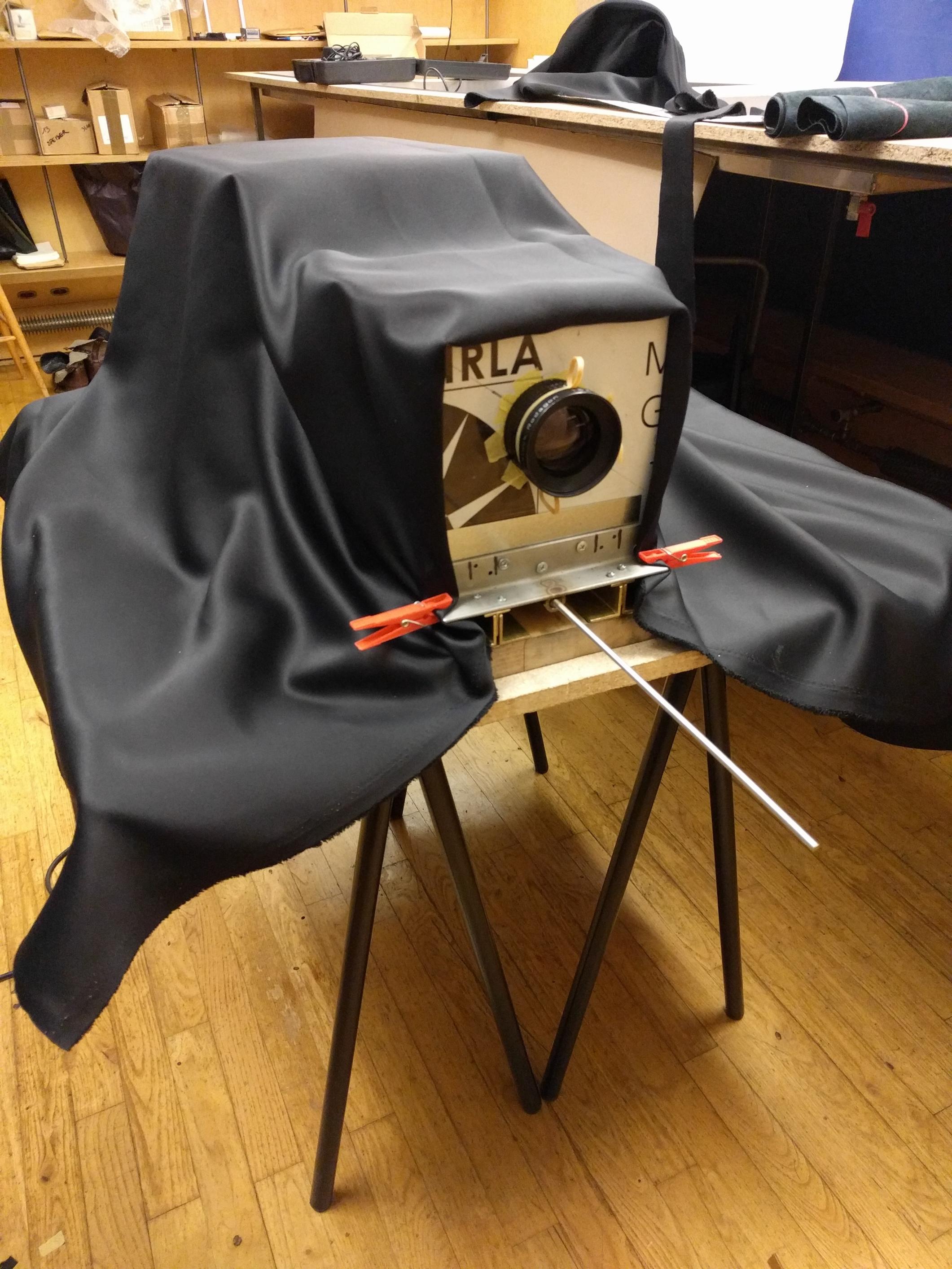

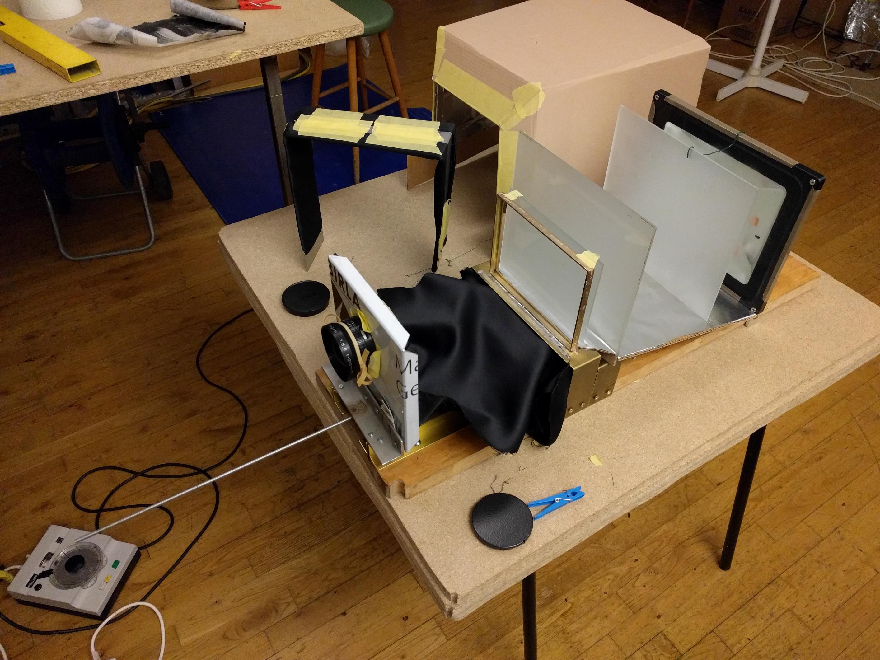

Chris, could you explain what want to show us in your two photos. As these are two different systems. Maybe both to form an enlarger at some point.
both are enlargers, fully functional.
one is a a transformed studio camera (pentacon mento panorama) the other one i built myself.
both use a powerful led lamp (flood 100w) and several diffusors (matte glass). maybe not as comfortable as a professional readymade enlarger but works perfectly well.
more pix
