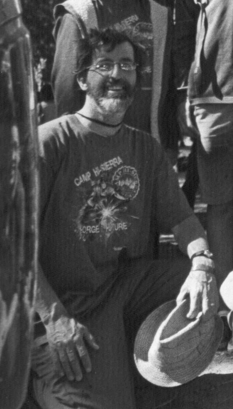

Here's a tight crop from the PERFECT print with satisfying grain.
Original is a dirty border print on 11x14 with about 1 inch borders. Negative is 35mm half-frame APX-100.
This crop is about 2 1/2 inches by 4 1/2 inches.
Herringbone pattern in the shadows is a scanner artifact not visible on the original print.
Herringbone on the hat is real. Just imagine if I had shot 400 speed film and developed in Dektol!
