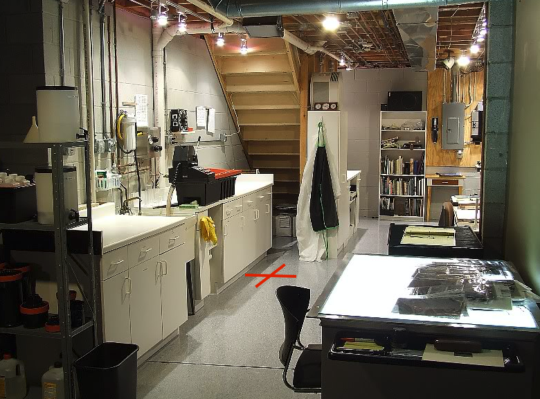

After 18 years in the same darkroom, looks like there is going to be a move in the next year. I never had a darkroom sink because I did not want the sink to limit the size of tray. However, now I'm yearning for a sink. Mostly to make setup and cleanup easier. It is just very cumbersome to wash the big trays I use in the tiny sink of my current darkroom.
In fact, if I look at the dull marks on the tile, it looks like most of the time is spent by the trays and sink.
So, at first I thought a walk-around sink would be right in the way, but as I think of it more, having the sink and trays in the middle might be the best place.
Another big factor is motivation. I'm so far behind printing in the last 5 years. Even though my current darkroom is pretty big, the space where I stand at by the trays looks right into a brick wall. I think I'm ready for a change. I don't want to spend all those hours looking at the brick wall anymore.

This is my current darkroom that will be abandoned. The red "X" is where I normally will stand to process prints (the Jobo is put away when printing).

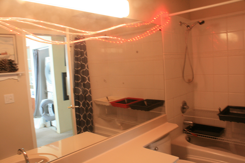

Most of the long wall in my bathroom/darkroom is a big ~ 4'x8' mirror.
There are three big advantages to a walk around sink:
1) If you ever do demonstrations, a sink that people can crowd around is ideal, because it is much easier for a number of people to watch at the same time;
2) If you do large prints with the help of an assistant, it is much easier to handle the paper if each person is at a different end of the paper; and
3) If more than one person uses the darkroom at the same time, it is much less crowded. It also offers the option of two sets of trays - one on each side.
The downside is the need for more structural stability in the stand, plus the slightly greater difficulty of providing extraction ventilation that doesn't draw fumes toward you.

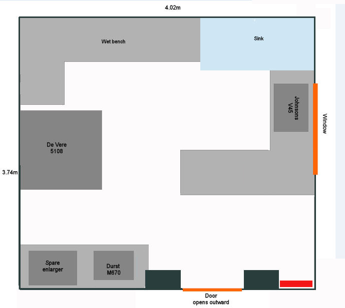

Walk around sinks are great for teaching darkrooms and multiple users, as your example, also in workshop facilities.
When I built my new darkroom 4 years ago after moving I had intended to have the sink come out 90º from the wet bench, but instead I have a bench that comes out 90º, to give more work space. My sink is 6ft x 2ft 4"
t's worth drawing out the darkroom and moving things around, on paper or onscreen.
Ian

Ian, I hope you don't mind me using your plan to get some ideas.

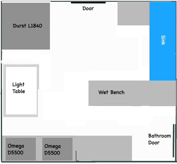

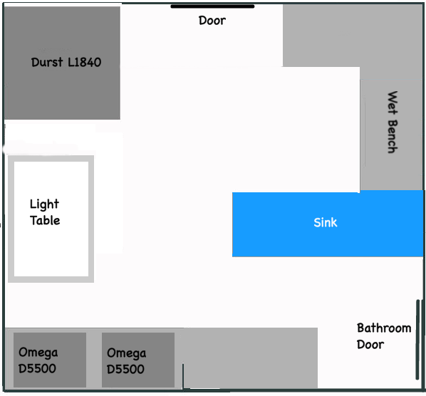

The wet bench is not practical with the two Omega enlargers. How about like this:
Maybe it is terminology, but where do you place the processing trays? In the sink or on the wet bench. I was thinking of a sink that allows me to place the trays inside the sink. And think of 'wet bench' as a place to manage bottles of liquids and stuff.
I prefer to have my trays on a bench, that's always been termed a "wet bench" in British and US photography books. The trays don't need to be in a sink but the bench must be of a suitable surface material, i.e. water proof, so any drips etc can be easily be cleaned up at the end of a session. I only use the sink with wash trays where I need running water., I also use it when mixing chemistry.
Typically I'm using 3 20"x16" trays when printing on my wet bench, that's Dev Stop, Fixer 1, and Fixer 2 and a holding wash tray plus the larger wash tray sit in the sink. I could shift along the bench so both Fixer trays are on the bench but I like to lift test strips and prints out of the fixer to examine them so prefer this in the sink.
The wet bench can be used for other things when not printing, which you can't do with a much larger sink.
