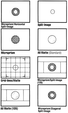

Does your camera WLF have a fresnel to help you focus? I have a couple TLRs which do have these fresnel screens and they are much, much easier to focus, even at waist height, than my WLF equipped cameras without them.
The screen I have is the very first one, at top left hand corner, micro-prism with horizontal split.
